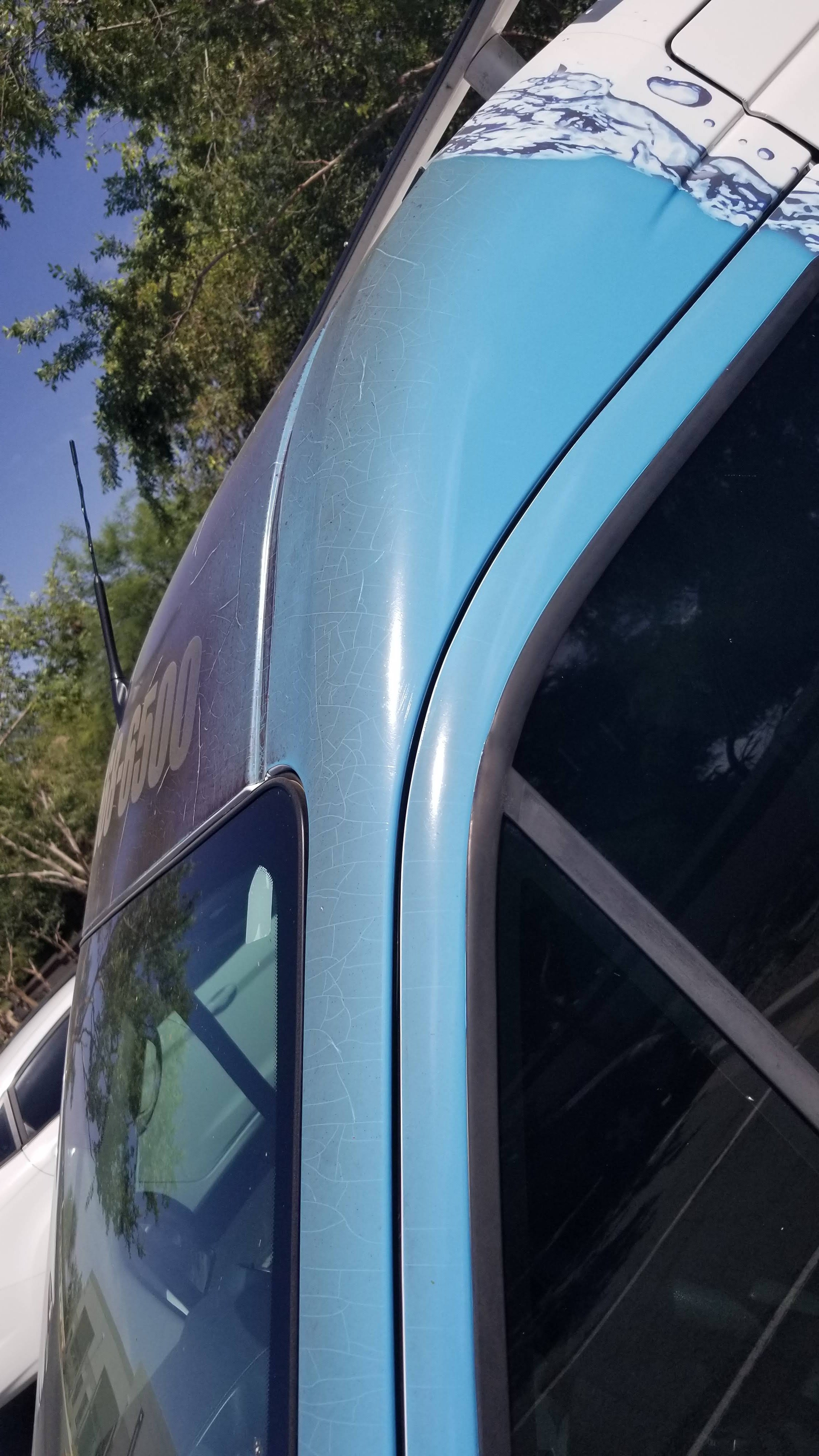

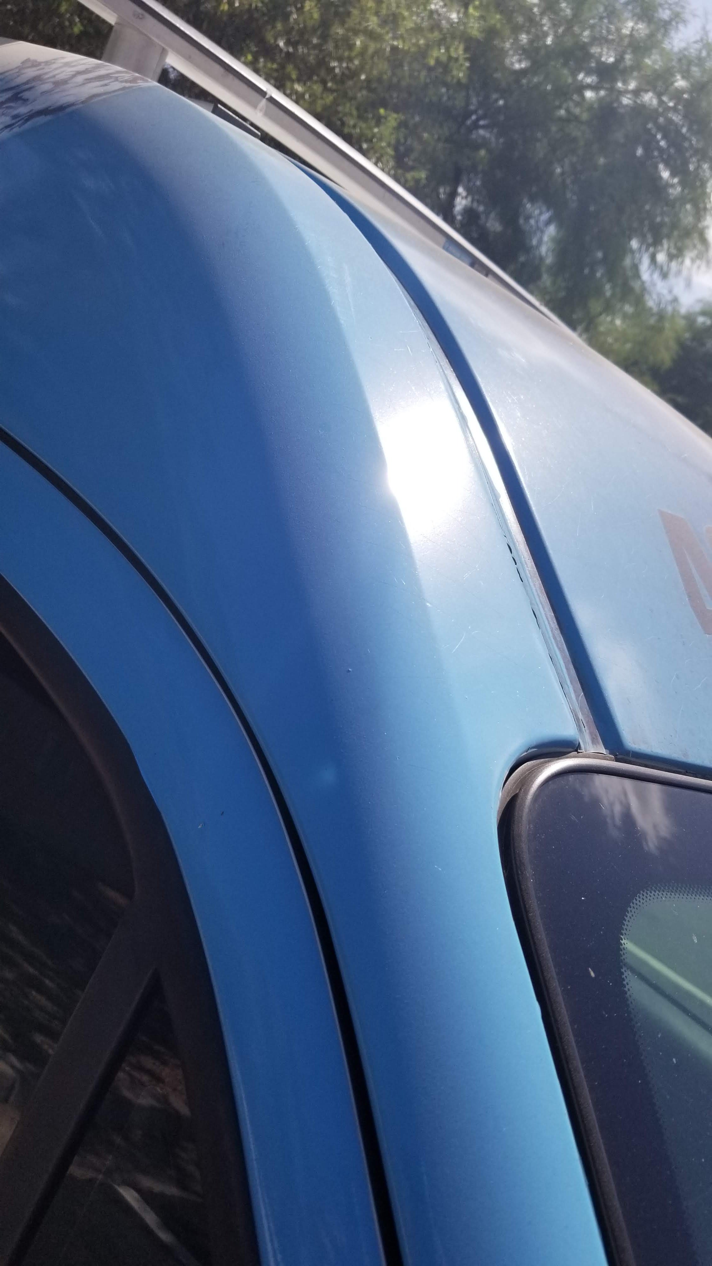

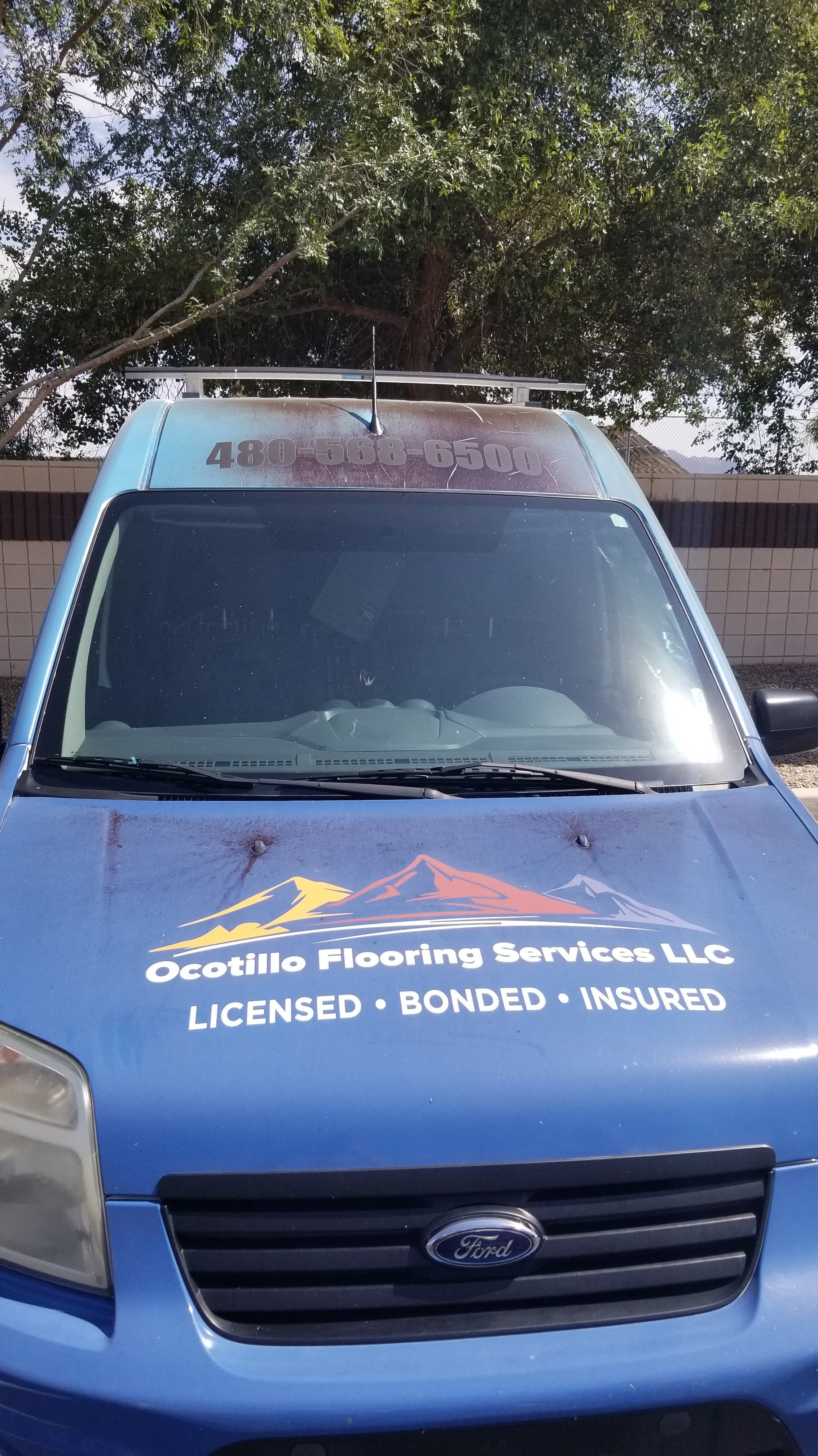

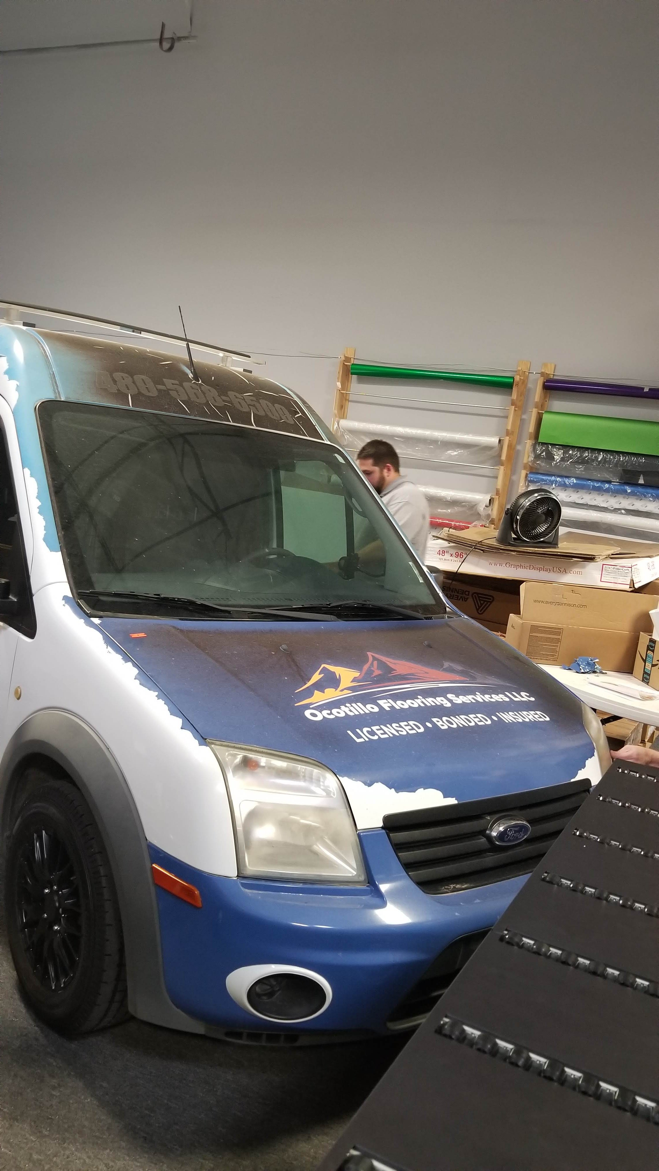

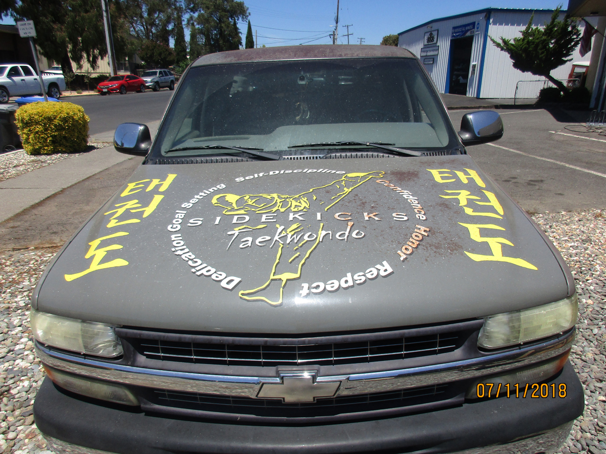

I don't do a lot of wraps, but have done a few over the years. These photos show a wrap I did in November of 2016. The original wrap was done in 2013 with Avery MPI1005EZRS / Arlon 3220. Portions of that failed so I switched to MPI 1105 Supercast EZRS DOL 1060Z lam, because I was told the brand combo was the issue. The photos show the portions I replaced and it'd doing the same thing. Weird thing is, I wrapped a fleet of vans back in 2014 and they still look good.
Any ideas?

It's not the vinyl, it's the laminate. The pictures show typical laminate burning. If you could remove the laminate, hypothetically, most likely you'd find the vinyl to be just fine. I've experienced this very same phenomenon in recent years. I stopped using vinyl laminates except in those rare situations where the client absolutely positively demanded it. I switched to Clear Shield Original Formula [I think it's called 'Classic' these days] liquid laminate and this problem disappeared.
On my own truck, which I sold last week, I wrapped the tailgate with a vinyl laminated print and applied three panels on the hood which were coated with Clear Shield. This was ~8 1/2 years ago. The tailgate displayed the burning after 4 or so years and I removed it as it was more of a condemnation than an advertisement. The panels on the hood looked just like the day I applied them when I sold it last week. Note that the tailgate is a vertical surface and the hood a horizontal surface. The horizontal surface receives far more UV than the vertical.
The liquid laminate is plenty tough but still doesn't have the inherent abrasion resistance of the vinyl but the liquid laminate exhibits far superior UV resistance.

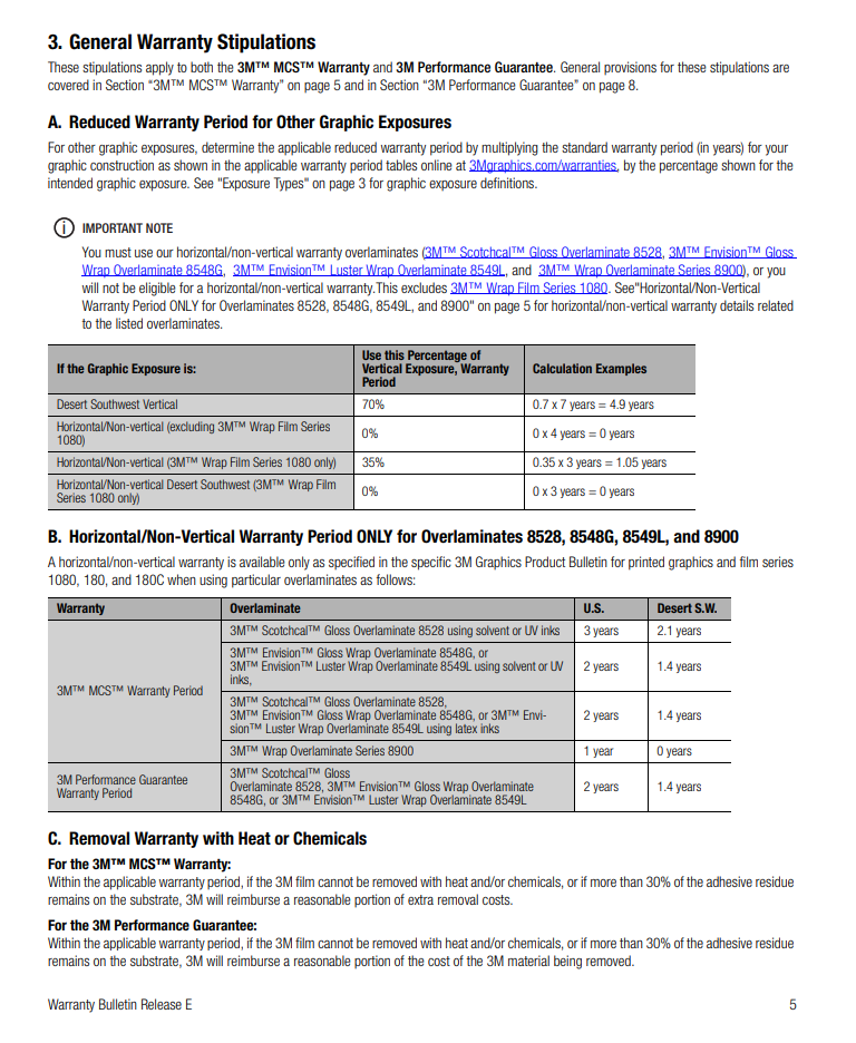

Didn't 3M come out with a special laminate years ago for horizontal installs such as roofs on cars and trucks.

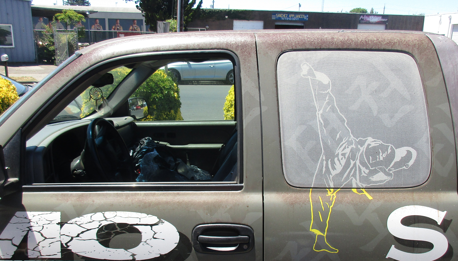

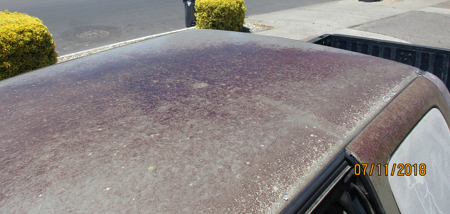

You got it backwards... 1360Z is 1.3mil vs 1060 is 2mil, Secondly we have been using 1360 and 1360Z for the last 3.5 years and are now experiencing burning failures from horizontal surfaces from anything done since the release of the Z series laminates so about 24 months ago.
I'm worried its going to be a continuous trend.
I have attached pics of one of the failures we have repaired. The outside pics were taken 5 weeks before the inside pic (when we did the removal last week). It took us nearly 15 hours to remove the vinyl on the front half of the transit using steam, pressure sprayer, rapid remover, removal wheels, and other chemicals... its been a nightmare!
