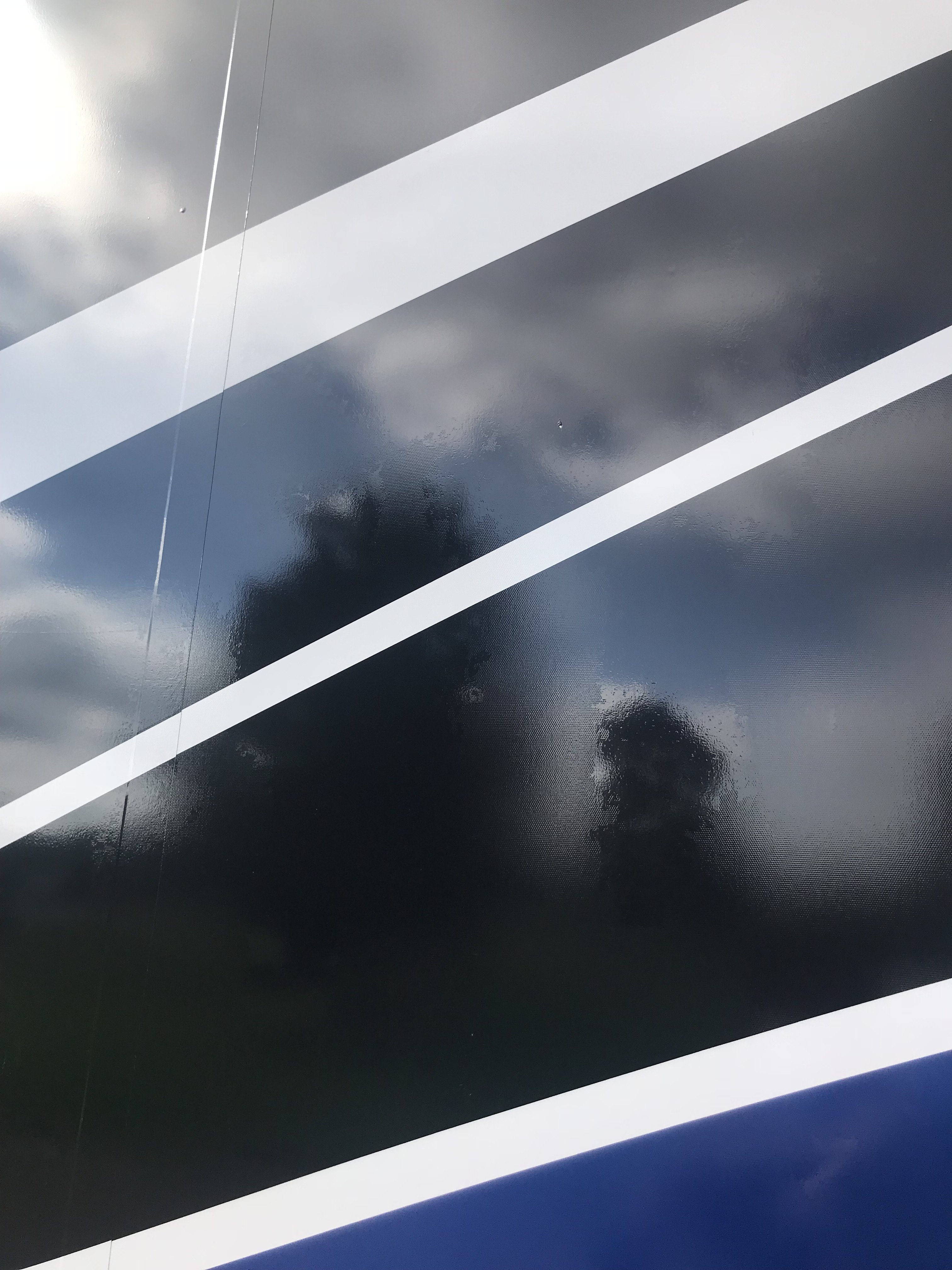

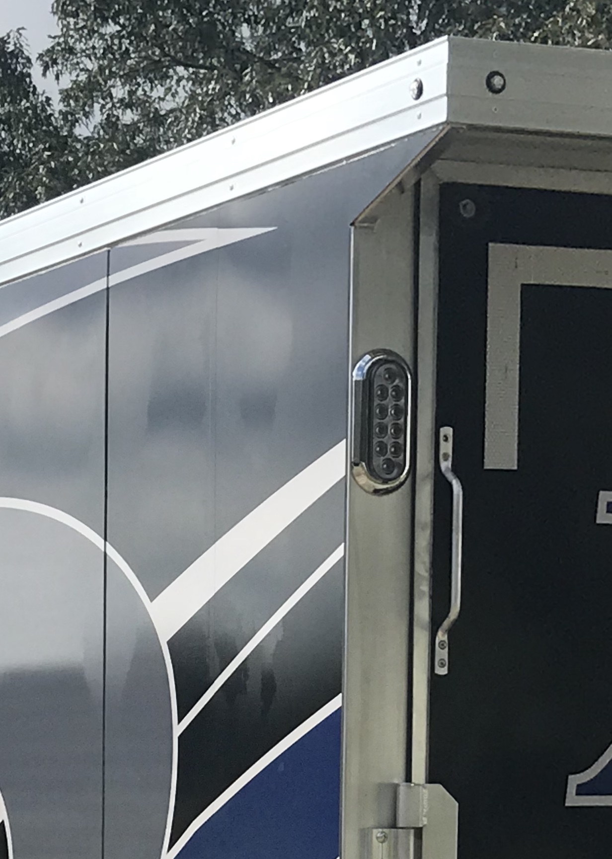

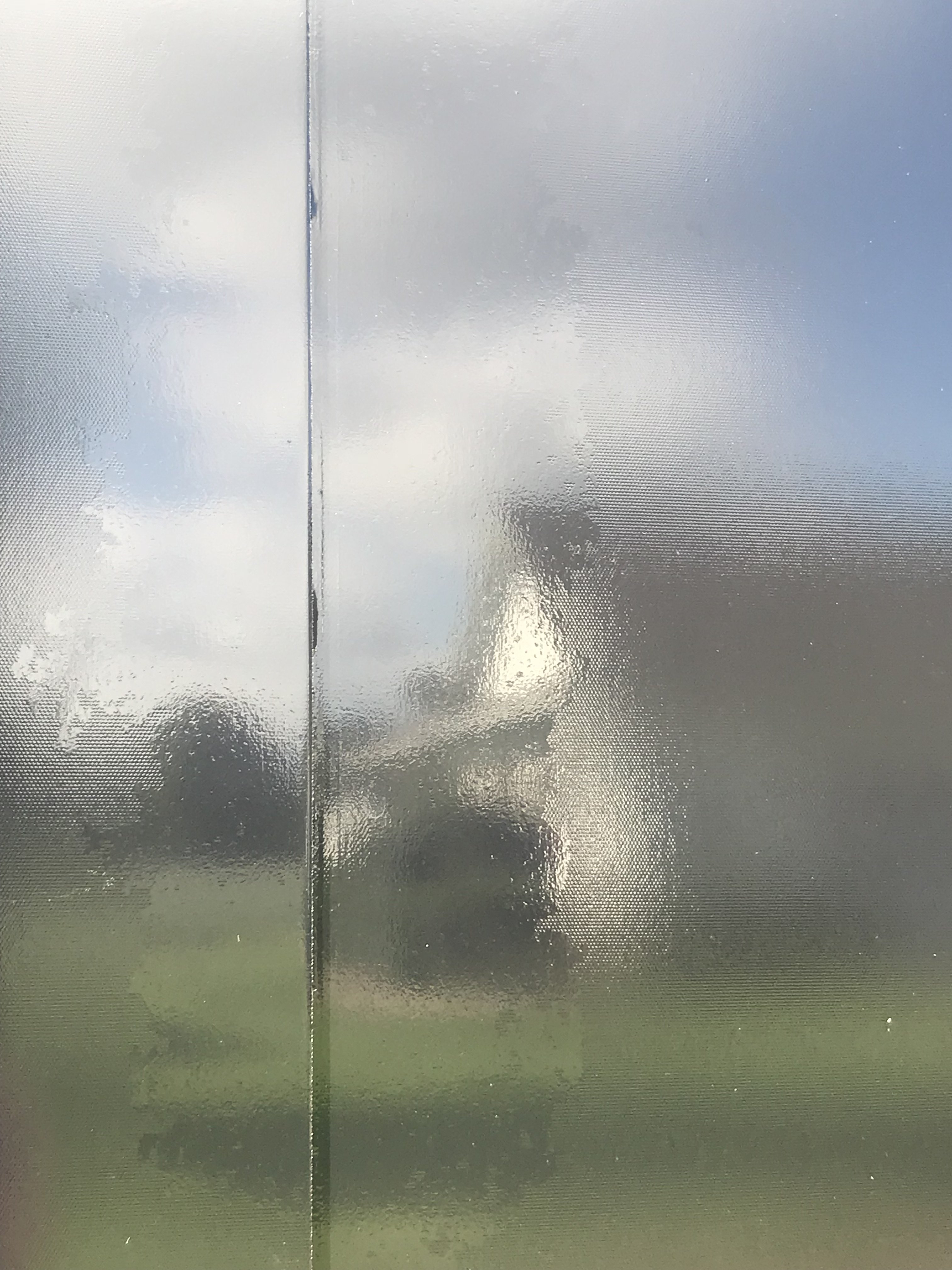

So we did a wrap job using Avery 1105RS with 1360 laminate. Went out Friday and the customer brought it back for us to look at on Monday and it looked like this (pictures attached). Any ideas what caused this? I have contacted my rep and sent pics and he is gonna get with Avery rep to see what their thoughts are. It was printed on a Thursday and Friday and was not laminated till Tuesday. It looked nice, glossy and clear when it went out. I would the haze is on about 85% of the wrap.

Looks like installer might've melted the vinyl. I think the grid is the adhesive pattern, and it's all outta wonk.

Ink was def dry, it is brand new trailer and cleaned very well, very little heat was used since it was flat surface with no rivets. May have used heat here and there just to take slack out to line up. I think it looks like something was used to clean it and it ate/melted laminate or something similar. Customer says he didn't use anything on it though and I don't see why he would use anything abrasive on it anyways so i kinda ruled that out. Waiting on Avery to try and give me a suggestion.

Maybe there were pressure differences in how you were squeegeeing the vinyl. It may have looked OK inside but once the sun got on it, it bubbled or expanded leaving very small air pockets.

So this, along with the fact that the hazy streaks sort of look like drips going down the side (in the further back photo), makes me think some chemical or cleaner may have been used?

OK, the sun hit it, since it's black it got to some crazy temperature and caused the vinyl to shrink microscopically showing the glue pattern on the reverse side.

It looks like the ink was not properly set before laminating.
Let us know which printer this was produced on.
I have sold and done training on all the inkjet printers for over 20 years.
I am guessing maybe it's a new HP latex?
I have had several of my customers develop this with the HPs and we have a solution.
