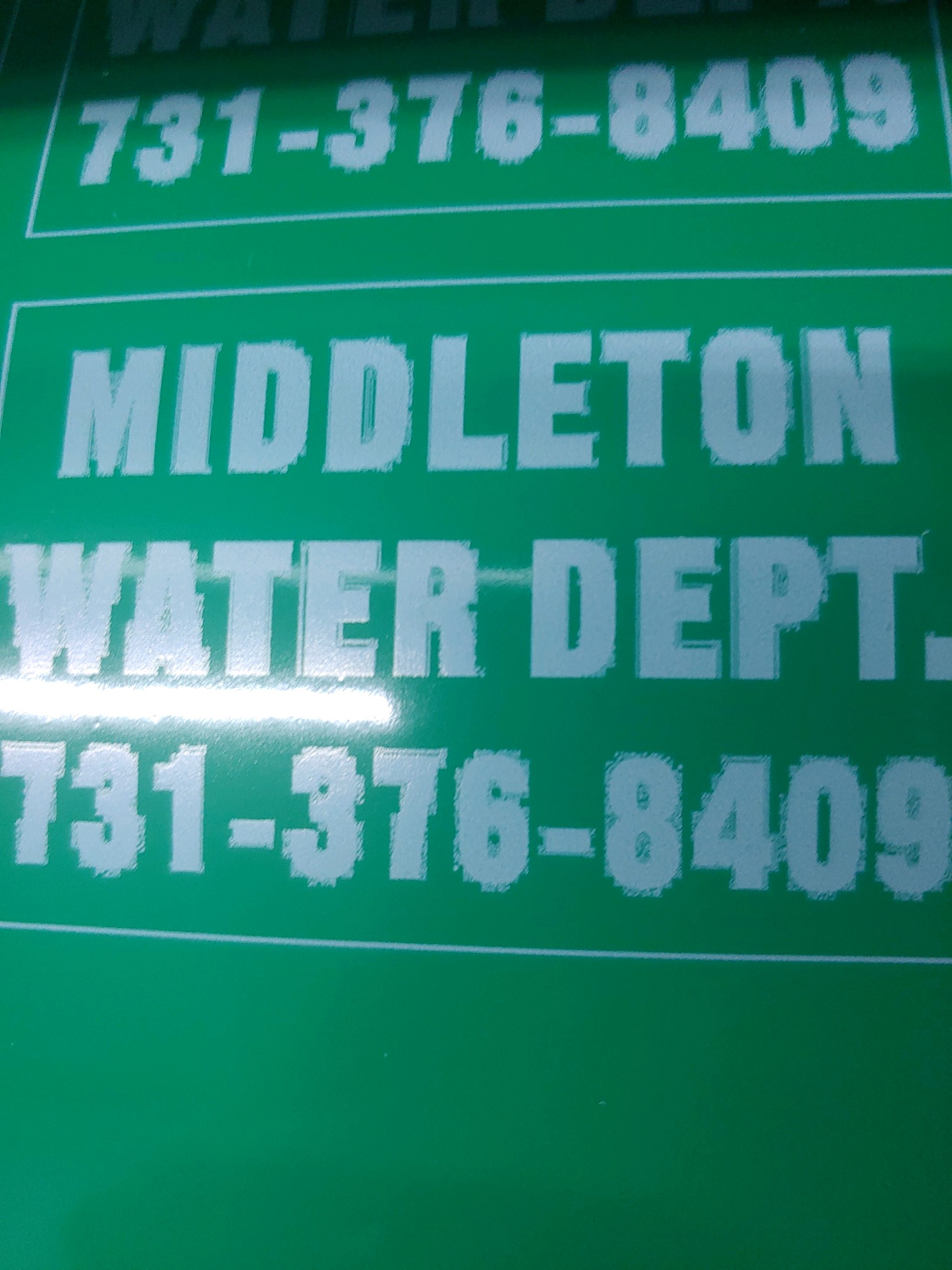

What is this mess?
Commando
What would cause this? Test print is fine. Other colors print fine.

could it be something funky in the artwork? what kind of file are you printing, and what RIP?
Commando
rasterlink 6. Its just gothic letters and a box.
I just tried to print it black and the quality was fine.

Try saving it as a file type that supports vectors and see how you get on that way.
Why always jpgs? I can think of a million reasons why not!
Jburns
So that is white ink then? and the black prints same file just fine - leads me to white head or ink issue.
Commando
Well, i was looking at the image in rasterlink, and when i transferred it to white, the "smudge" or whatever was in the image itself. When it was black, before making the white profile, it isnt.
I exported it in EPS and its fine. Job is now done.
Pretty freakin weird but ok..
The white will print wherever there is a pixel value that is not pure white. If you look at the jpeg you were trying to print in image editing software, I will bet you see color values at the edges that you thought were white. Rasterlink will see that value and print white. When you converted to EPS, those values were stripped from the file. It's a characteristic of jpg's, the jaggies, which is why jpgs are best saved for use on the web and email, not so good for printing...
