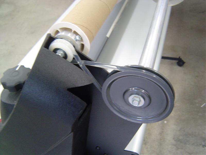

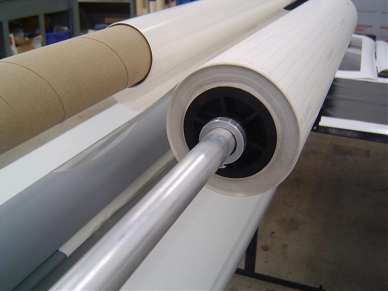

One really good thing - I can now use Oracal because it's reverse wound - if you have a Daige and don't know this - I just put a figure 8 in the drive belt to reverse the direction of rotation on the take-up reel. However, I do have to hand roll the take-up reel for the backing by hand about 50% of the time.

The easiest way to use Oracal on the Daige, which I love, is to put the lam on the top roll and have the material feed from the TOP of the roll. The liner goes directly to the take-up reel and the lam feeds under the take-up reel and directly over the top silicone roll. Let me know if this makes sense. If not, I'd be happy to talk to you about the correct procedure. No need to change the belt on the Daige. BTW, which model Daige do you have? The Model 4 is a significant improvement over previous incarnations.

Yes, it's a brand new daige 4.
Here are some pics of how I'm loading my oracal. Is this not correct? I flipped the belt to make a figure eight to get the take up reel to spin the right direction for the reverse wound oracal.

All the Oracal laminate I've seen is reverse wound. It's hard to tell if yours is reverse wound. You should not have to flip the belt. Just have the lam come off the top of the feed roll with the release liner going directly to the take-up reel. Feel free to call to discuss this.
