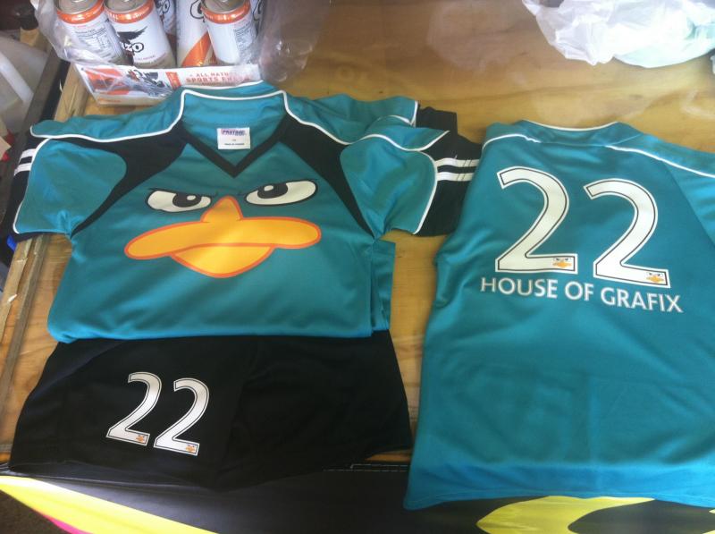

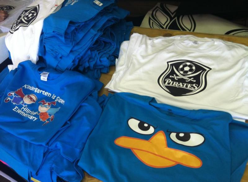

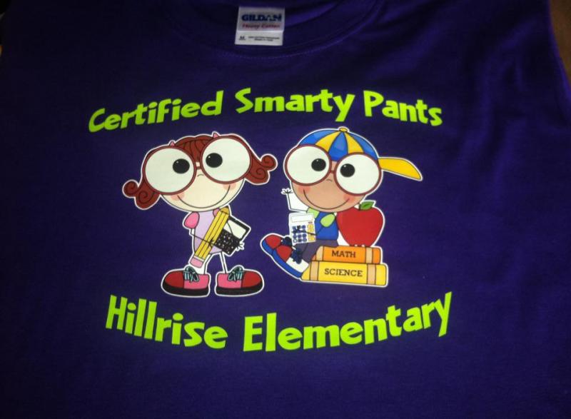

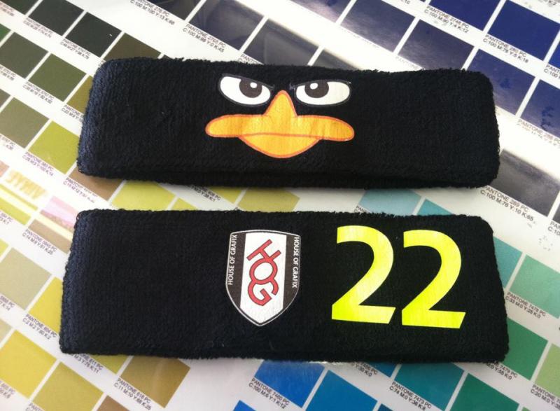

I use the rtape flexprint tatoo and love it so far.
You can get it from fellers for 126.00 for 19.5 x 20ft
There is no wait time to dry and as soon as it comes off the printer I premask and press it.
I do a lot of soccer jerseys and they work great!
attachment.php
attachment.php
even on headbands!
attachment.php
attachment.php
