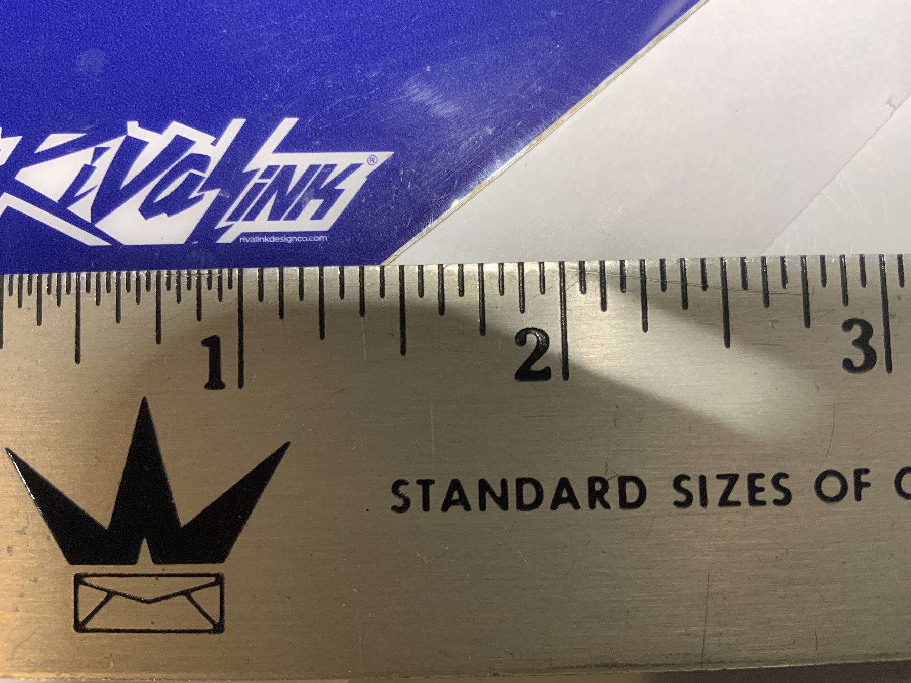

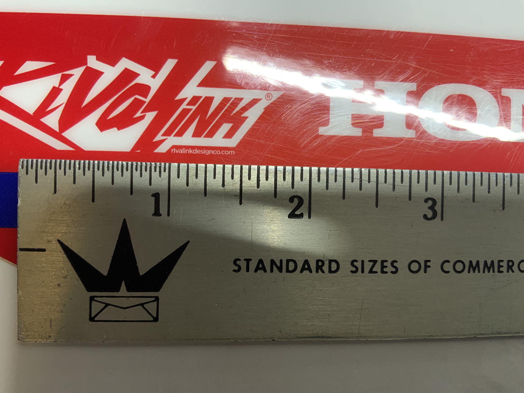

I also bought a used dirtbike and it has an aftermarket graphics kit on it from a company in Australia called "Rival Ink". Looking at the quality of their prints, I was floored. I've attached photos for you to see the detail in the tiny type under their logo. For comparison, there is a ruler in the shot as well so you can see how small it is.

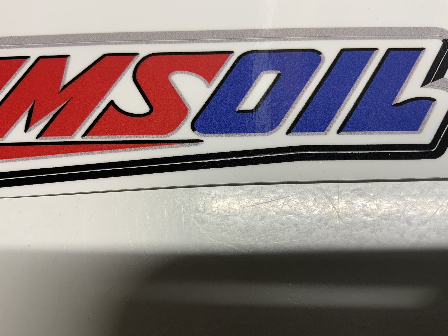

I printed some decals using a HP Latex 560 and the best print quality I could get resulted in a more "speckled" or "mottled" print. You'll see in the pics...
I've heard the Epson printers have a finer pico-liter droplet size (not sure if I'm saying that correctly) but would that make the difference between my old Roland or HP and their beautiful, non-speckled prints?
Just curious as to what kind of printer has this amount of detail??

Yes Epson based machines will have better quality than the HP Latex. Your Roland printers also use older Epson heads which is why you see them getting closer to what you want. The newest Epsons have the TFP heads which have even smaller dots and better accuracy.
rjssigns
My Mutoh with DX7 head prints crisp text at 0.060". Anything with a DX7 head or one of the Epson printers will print solid colors that look like cast vinyl.
If you want better prints out of your Roland run it in Unidirectional. Slow but makes a better looking print. Can also cover up some issues caused by an older set of heads.

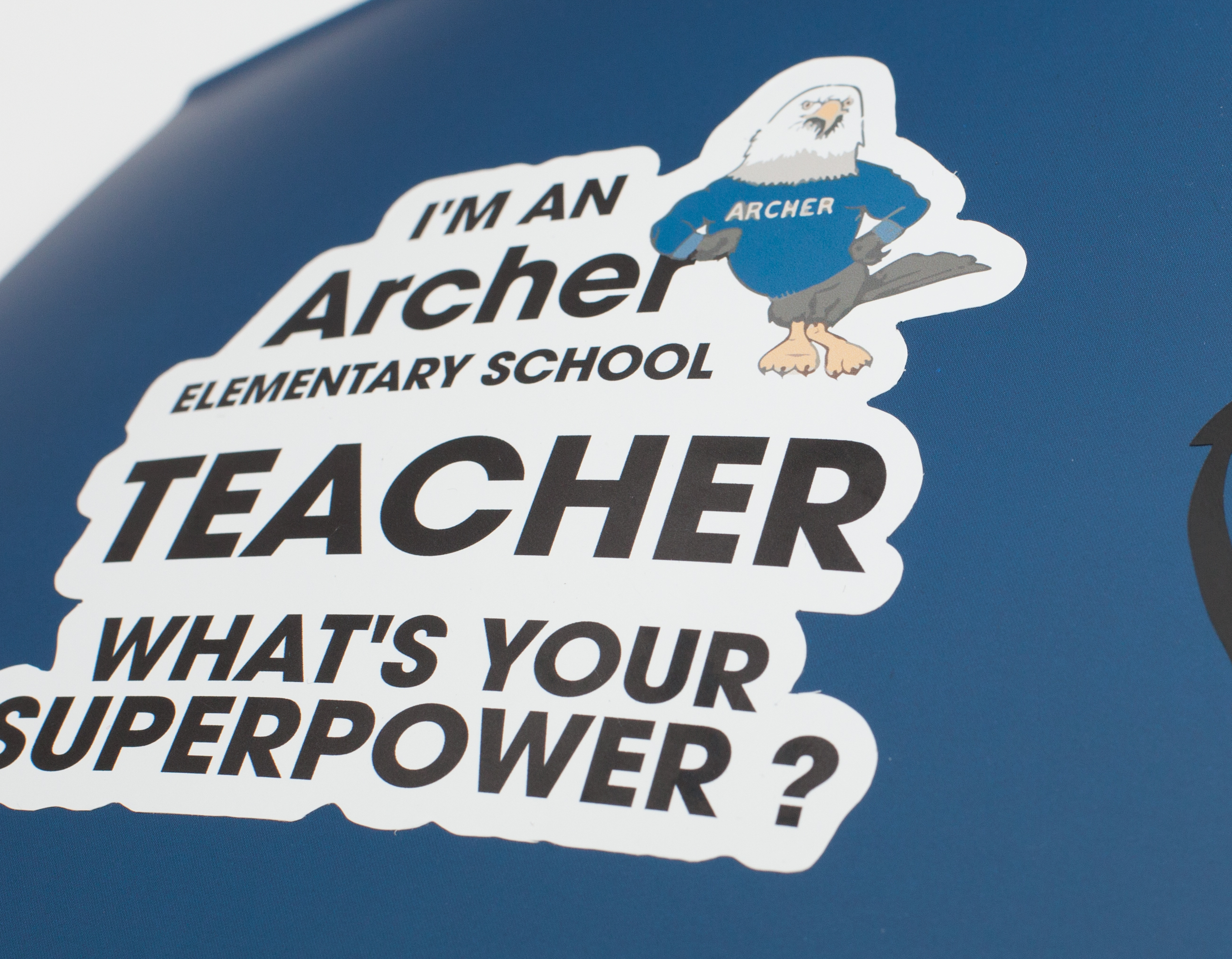

The blue background is an offset cardboard, the print was made on a mimaki cjv150, nothing fancy just plain CMYK
