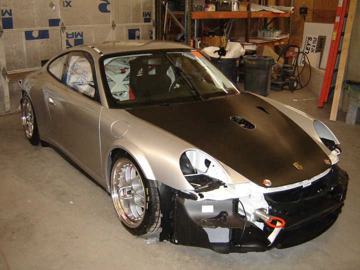

+1 for Oracal 970RA
We did two of these Porsche GT3 cars with it in silver metallic. The hood and trim was 3M carbon fiber.

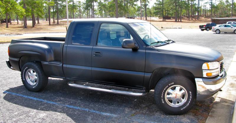

More Oracal 970RA in matte black. One thing of importance on Oracals films. Do NOT use Primer 94 with it and avoid letting it touch the vehicle before squeegeeing if at all possible - it does not like getting pulled back up for repositioning and it does not play well with primer.
Looks great though and overall it is easy to work with and install. Fender flares..... pshhhh those aint no fender flares in that other thread.

Not at all true. The Porsche that's pictured above got wrecked a few weeks ago. I had to re-wrap one whole side of it with no help (other than a mechanic who helped for 2 minutes to get the paper off). Let's just say I had to reposition it a few times.
