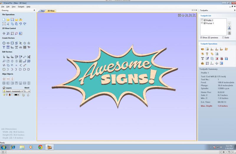

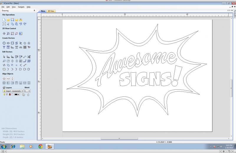

Alright, check it... I took me longer to come up with a fake sign design, than it did to show you the creation of tool paths etc...
Now if you notice in the lower right hand of the screen it tells me how long it will take to cut this out. Obviously an estimate, if I played around with the perimeters more, I could dial it in. But for sign foam, this is a good estimate.
So by my shop rate that would cost $42 worth of cut time. Plus how ever much it would be for the sheet of HDU. Now keep in mind this has nothing to do with priming, sanding, painting, sealing, coating etc... those are obviously based on your shop rate, not mine. But I could let this sign go out the door for around $800 - $1000 on the low end. So, I'm not really worried to much about the 15 minutes it would eat up if my designer were to figure out cut paths and tool changes. Big deal.

Now obviously I'm a big fan of V-Carve and Aspire from Vectric. See how fast that was. You don't have to know CAM stuff, and can still design in your favorite vector software. I made the logo in Illustrator, saved as an .eps the opened windows, and imported it in to V-Carve Pro. Plus the software is super cheap, and compatible with anything can can run G-Code. They have a huge list of exportable file types from Haas, ShopBot to Zund etc.

We don't operate like that. We draw the artwork in illustrator to customers spec, print to flatbed printer, then route. We design the artwork with a spot layer for our cuts and only use the cutting software to select tools, initiate cutting/routing, etc. The example you showed looks like a very generic simple sign which we rarely do. Our signs are often multi layer (stand-off), have different types of cuts such as depth engraving, etc.

The more I look at that software the more I like it. It seems like it could save me some serious time. Hrmmmm....
