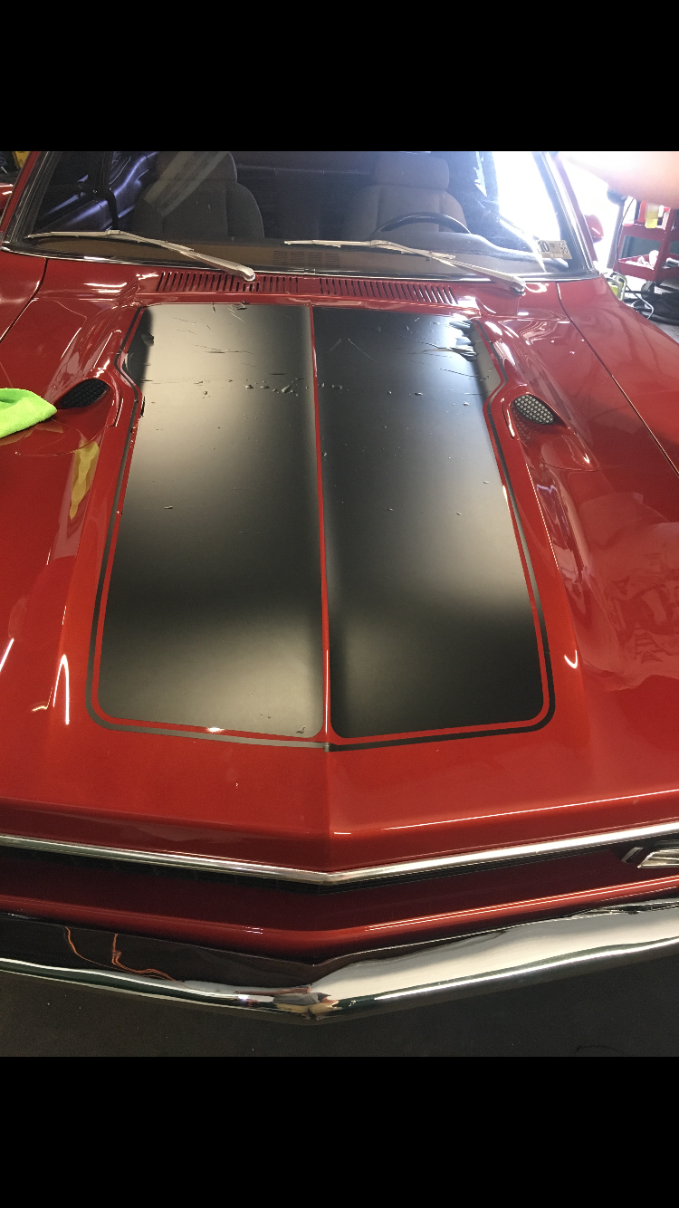

This is where it was before trying to pop any bubbles. The line of air bubbles is where I tried spraying it. The vinyl stretched in the back from trying to reposition it. And wouldn’t stay down in the dips after being wet. It had a heavy paper transfer tape on it.

View attachment 141902 This is where it was before trying to pop any bubbles. The line of air bubbles is where I tried spraying it. The vinyl stretched in the back from trying to reposition it. And wouldn’t stay down in the dips after being wet. It had a heavy paper transfer tape on it.

It looks like calendared vinyl from how crisp those wrinkles and bubbles are. Matte is always more difficult. Did you do this as one solid piece or split it in the middle? Don't listen to these fools, that is a difficult install because of the hump in the middle.
Call Graphic Express and tell them what happened and show them pictures, maybe they will discount a replacement.

I was pretty suprised myself to be honest. Which is why I incorrectly assumed I could get it on there no matter the vinyl. I wrap cars with wrap vinyl however, and this stuff was definitely not wrap vinyl. Anywhere it touched the car, it was stuck, no squeegeeing air from under it, no pulling it back up without stretching, and once I tried spraying it...I knew there was no saving it.
I'd say it's poor vinyl and not installer friendly. There is some really good air release matte vinyl out there that wouldn't do this. Contact the eBay seller and see if ya'll can work something out.

I attempted this install all in one piece. I couldn’t split it because the pin stripe contour was solid all the way around.
