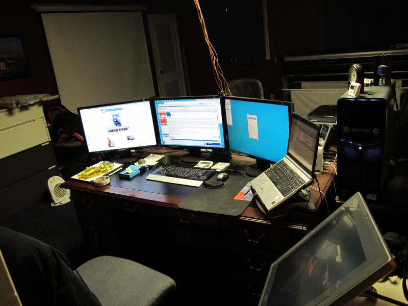

Here's what I reccomend
(3) 24"HDMI 24" samsungs
(1) 100" high end 1080p Optoma projector
(1) VAIO laptop 13" very portable
(1) 21" Wacom Cintiqu screen tablet which can simultaneous display on any of the others.
