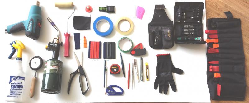

What would you guys add (or remove) from this wrap install kit?

I would remove the tape measure. Anyone who's remotely interested in doing wraps should already have at least one.
Replace the scissors with a "snitty" cutter.

Swap Wrap Cut with Knifeless Tech System's tape. Swap Sealit Pen with Edge Lam. IR Gun combined with Torch...lol.
Geek Wrap squeegee is too stiff and the buffer wears out too fast. Get a lidco Teflon Squeegee and add your own changeable buffers.
Get a medium and soft squeegee with buffers as well. Not sure why you have an exacto when you have a snap off blade...I'd go with a multi-cartridge knife by NT Cutter...worth every penny.
Rolle-Pro $50 vs foam roller $2...do the exact same thing. Here's my Kit...for the most part.

... Not sure why you have an exacto when you have a snap off blade...
Snap blades for long, straight trims and x-acto for tight, intricate trims with curves and corners. Too many years of practice spinning the barrel of a x-acto knife to go back now. It just doesn't feel right pulling that flat snap blade handle around a corner radius. Hahaha

I understand the control and sharp angle. That's why using the 30 Degree blade is worth the extra cost.
Highly recommend trying the 30 degree blades in the breakaway NT Cutter. There are so many reasons to use that knife over the olfa knife. Trust me...try one.

I am looking for the breakaway NY Cutter but all I am finding has the flat handle like the OLFA. This flat shape prevents me from easily and accurately spinning / rolling the blade with my fingers. From hand cutting mask, Unalo / rubylith film, Spaylat, drafting pencils etc. I have built up so much muscle memory that my fingers MUST spin. :Big Laugh
Is there a breakaway cutter that also has the round handle shape? I would be all over that!

The NT Cutter is rounder than the olfa...but it's not going to compete with the exacto in your hand as far as your acquired muscle memory.
