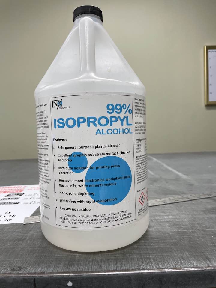

Had this for a bit. Cleans pretty well. Try that and white gloves.
