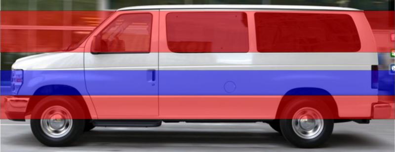

Here is an image showing what body lines are straight horizontals. The visual shows what ProWraps was saying "the only "straight" horizontal line on a ford van is the indent groove about 12" above the bottom. its is straight to the vehicle the full length." The bottom of the doors and the bottom of the van between the wheel wells are straight too and you can hook a tape.
Where the OP installed the graphic I would have used the top of the "belt line" It is the closest strong horizontal. When in doubt position the graphics where you think they should be and stand back as far as you can and check at the graphics on the vehicle. We always cut our graphics square because the liner and mask influence what you think is level. If your doing 50 truck doors you can stop measuring after a few and eyeball the graphics.
