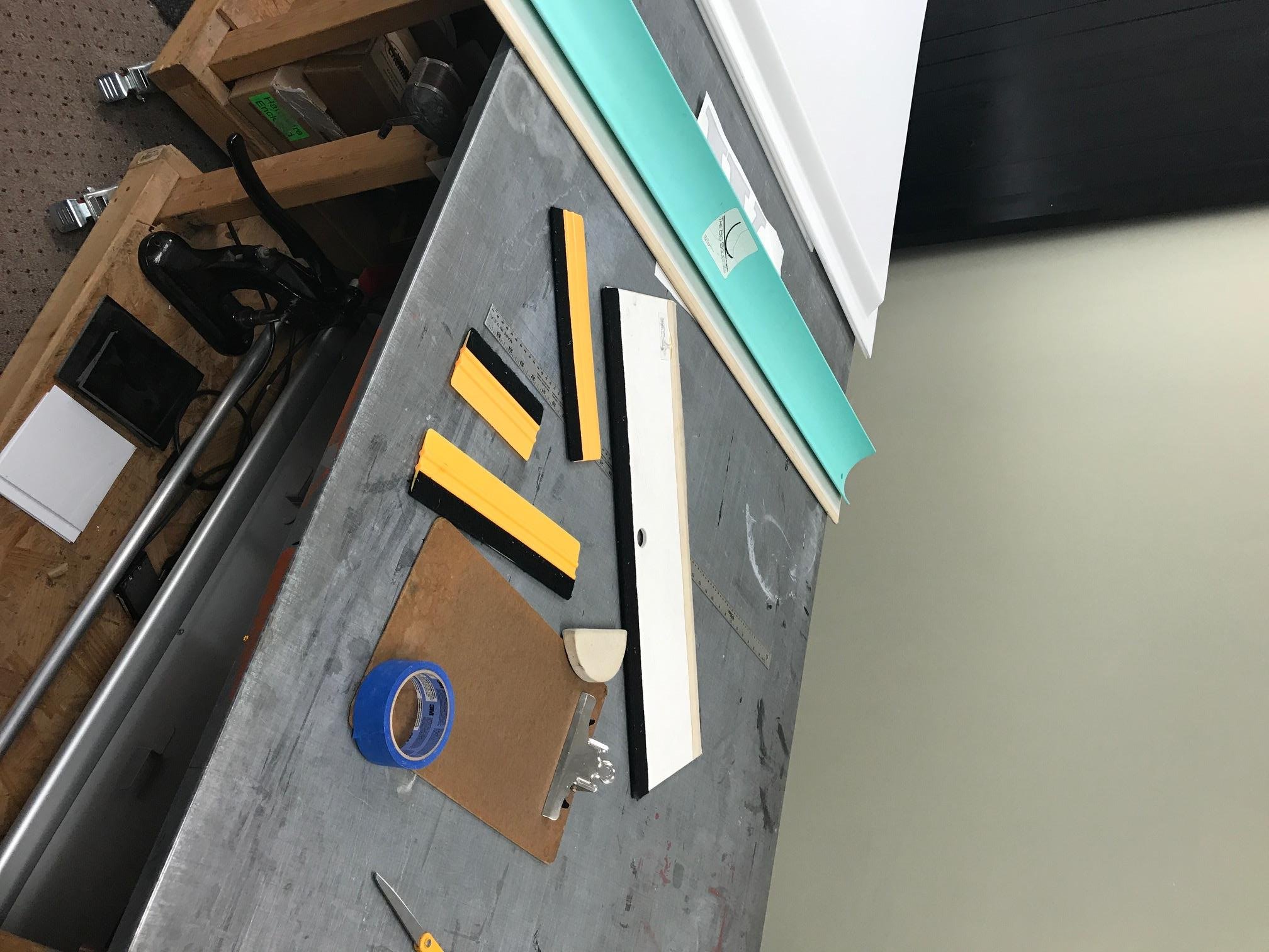

Cheapies. I use the solid felt half moons as well.

Cheapies. I use the solid felt half moons as well. And an
I love those ones, especially for unlaminated prints. It also is easy for me to get our air bubbles and wrinkles with those ones.
We have the 3M gold ones as well, amazing, but I prefer the ones with felt on one side so it doesn't scratch prints.
