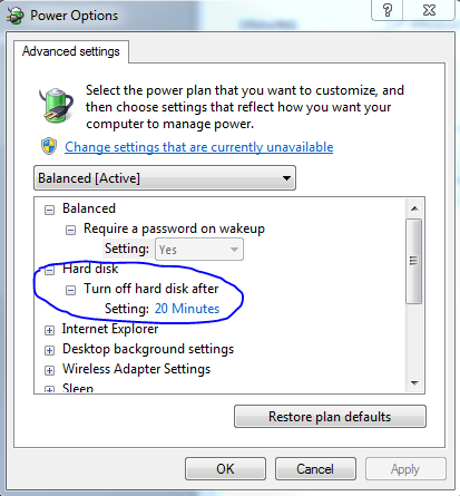

Probably in the Power Management settings, where you can tell your computer to put monitors, hard drives, etc. to sleep, or hibernate or never do any of the above.
Andriy
Hi,
Have you tried adjusting the Turn off hard disk after setting in the Advanced Power Options?
I'm not positive if it affects every hard drive on the system but it's worth a shot.
attachment.php
phototec
Thanks guys, the hard drive was set to SLEEP after 20 minutes, so I changed it to never.
However, the C drive and two other USB external hard drives NEVER loose access, so not sure this will fix the issue, but I will give it a try and see what happens.

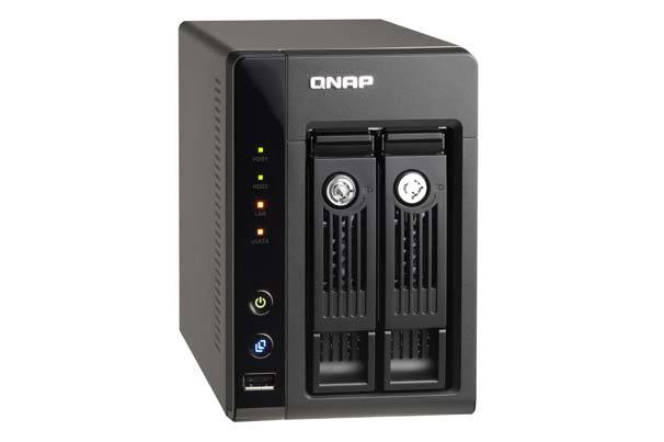

player
Might be time to get a copy of Acronus and do a complete mirror. Check online because some of the hd mfgrs offer a free version if you use at least 1 of their disks.
Would also be a good time to check out an NAS backup unit.. QNAP makes a good one.
