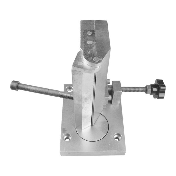

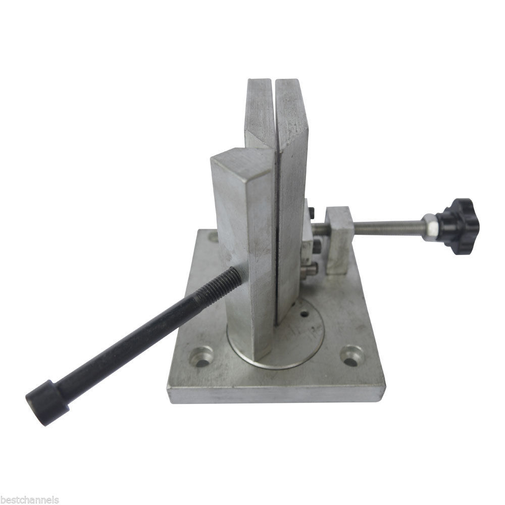

For hand building channel letters, a little hand bender like this In US Stock, Dual-axis Metal Channel Letter Angle Bender Bending Tools, Bending Width 145mm: Amazon.com: Industrial & Scientific is a MUST have...
With a bit of searching you still can find one... I built one similar copied from a very old one that a friend had.
