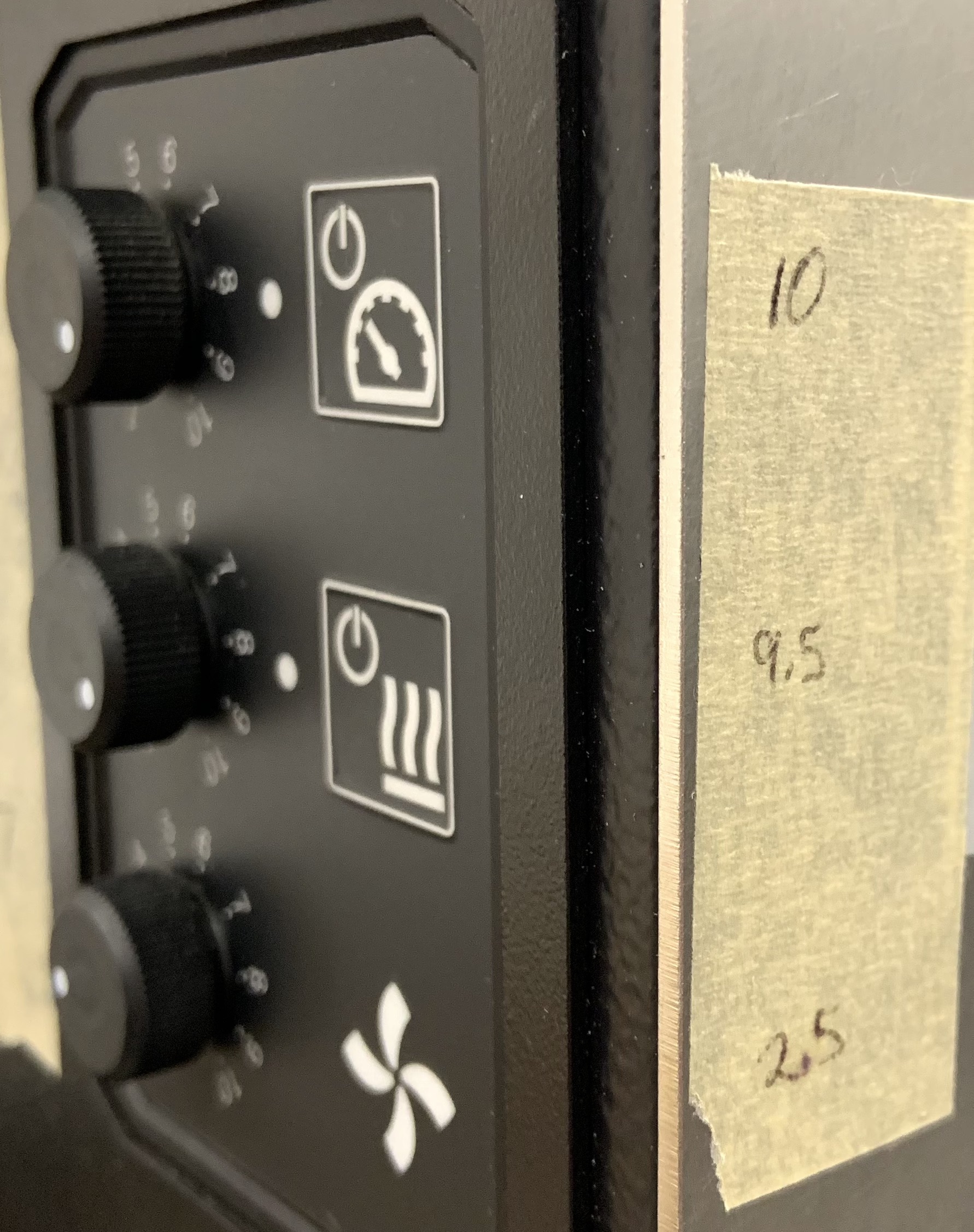

    It's a great machine. Take an afternoon of scrap material and by the end you'll be a master! I have several settings taped to the side of ours in case we messed around too much with and we need to get back to what we know works.
    Start off slower, then move faster as you become accustomed to it. What that means though is your heat and fan speed will change if you slow it down. We pretty much run ours at the full 39ft per minute, maybe slightly under. IMG_0491.jpg
    We do change it a little for mesh as it will melt too easy.

    The last thing they told us is we need a table that is 5' of feed in and at least 6' out feed... How big is the table you run?
  9. brycesteiner
    brycesteiner Member
    385
    37
    28
    Nov 5, 2014
    Ohio
    The table we run is 5x9' total. The feed in is 7.5' and a little less than a foot for feed out. We used one of the large tubes that the banner comes in to make it roll off the table cleanly without possibly scratching.
