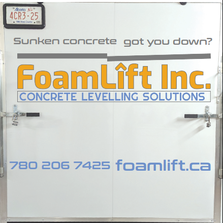

Regarding the design.... Think of this as making a billboard, not a brochure. Most of that content is not necessary. Arrange logo, contact, and a Shorter summary of services to attract attention and state the purpose within about 60 seconds. Use negative space to guide the eye.... Quickly.
The back can have more... It will be stared at by a couple people in traffic for a while.
Don't do anything on the front of the trailer, no one will see it, and it Will get trashed from travel... Especially weather travel.

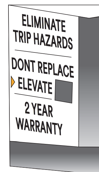

Here's my 5 minute take on the design. Not pretty or polished by any means but meant more to show how much coverage I would aim for.
Customer might put up a fight but I'd lose at least 50% of the random thoughts that he wants to have on there. It's a billboard, not a short story.

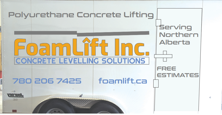

I agree, the design isn't great but its closely based on the customers pencil ideas. I'm mostly concerned with the logistics of material choice at the moment and price estimation. Thankyou for the head start on that. And the outlines are going to be removed as well as the fonts changed. Unfortunately the colors have to match his existing logo which is the grey and orange logo on the sides.
This is what he sent me to work with.
He's trying to get bang for his buck ofcourse but should i just tell him that the design is too text heavy? Worth mentioning this is my first real customer.
As bad as it sounds...you have to learn how to manipulate your customer. In the end, you give them what you want... but They arent the professional here.
Ask him to spend the day looking at other peoples vehicles - See if he can find one that has as much information on it as his does... And in the rare case that he can, then ask him how much of that vehicle he ended up reading while at the red light before it turned green.
Quote his version really high, offer a dumbed down version like white Haus's - Show him how much better it looks... And explain to him how it uses half the vinyl, half the labour in prep work / install... And costs half the price of his version.
As for Material... For this vehicle I'd use 180. MAYBE Ij40 if there are no rivets or curves and its all going on a flat surface and the customer is on a budget..

Looking at it again... Are you going over the silver vent? Or is that grey square by elevate supposed to symbolize the vent? in which case I think your scaling might be quite a bit off

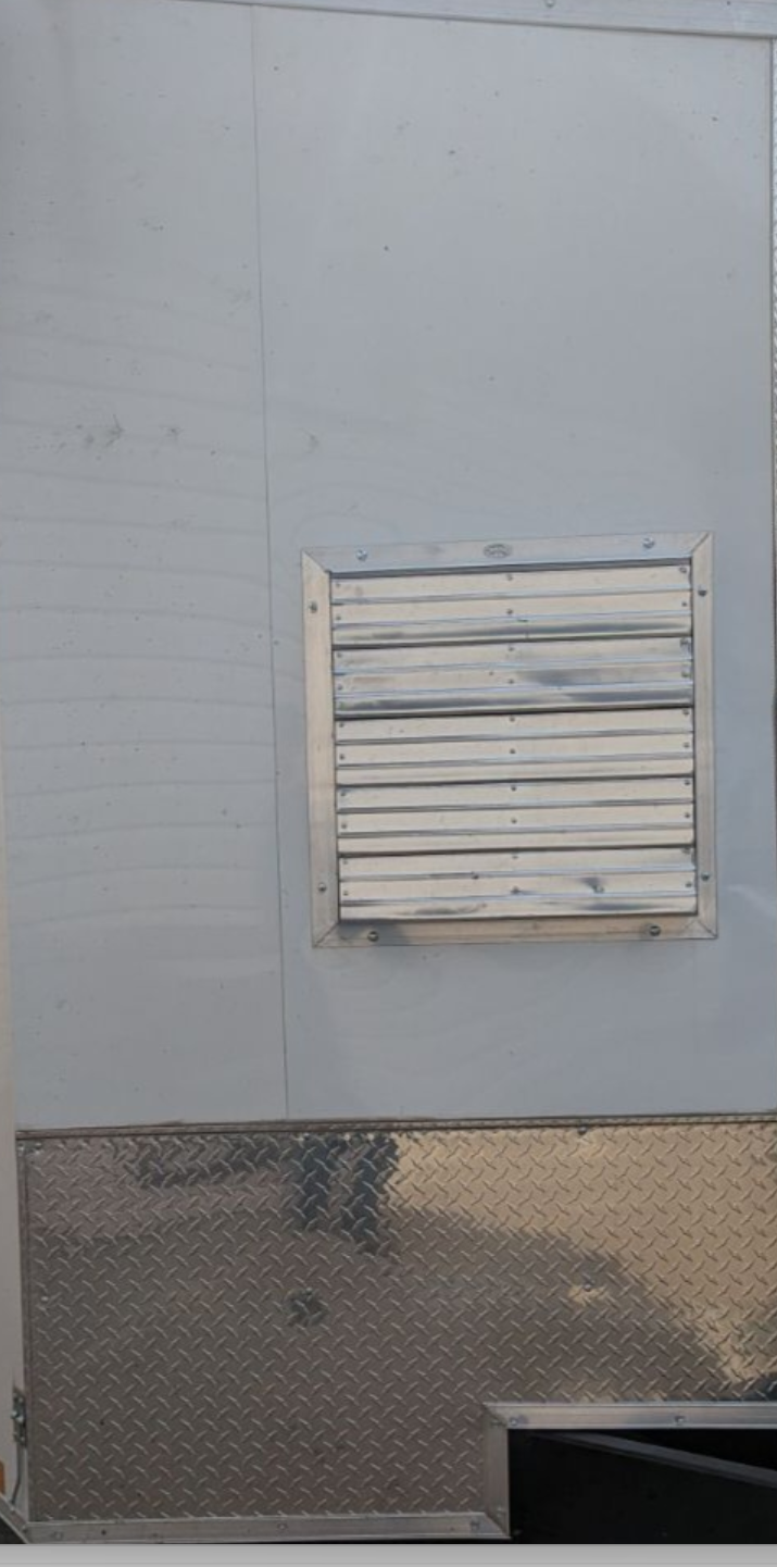

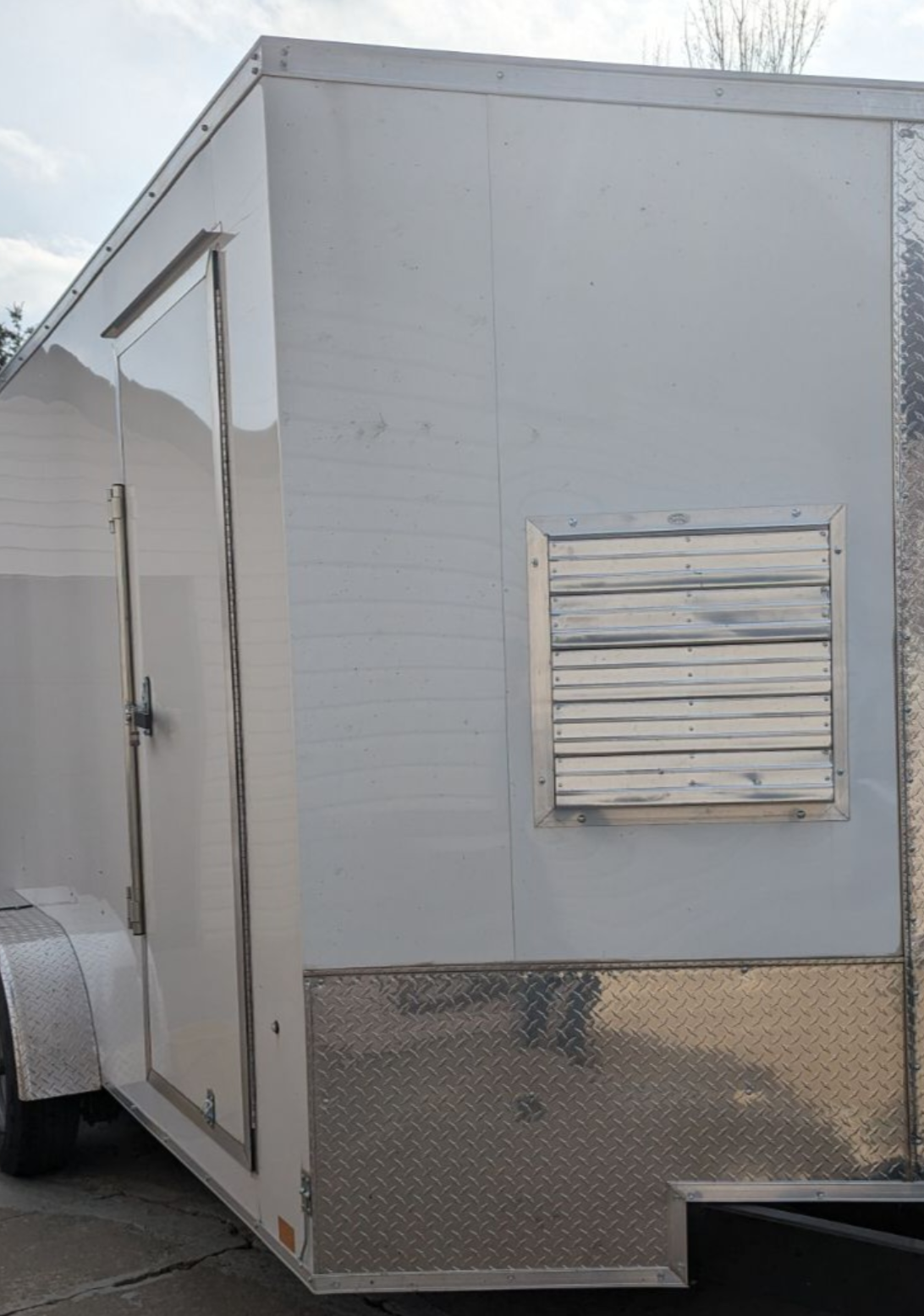

Thanks! Thats a great idea for making sure everything will fit. I will get those photos and try it your way. I dont think anything is reflective at the moment. The reflective material i mentioned earlier was just what we have on hand thats vehicle grade, but after White Haus's input i will not be using that stuff.
When you take these photos tape a 16x24 framing square on the trailer. It can be most anywhere in the shot but closest to the center is best and square to the trailer is a must. Do this for each side as well as the front, and back. Shoot each side as straight on as you can. When you import these photos into AI or whatever, draw a rectangle around the framing square in the image. Do whatever it takes to make that rectangle fit the framing square and closely as you can. Then map the photo into that rectangle [note that I say 'rectangle' but I mean whatever four sided object you ended up with that fits the framing square in that image]. With the photo mapped into the rectangle, make that object a 16x24 rectangle. Unmap the photo and you should have a full scale straight on image. Doing this eliminates any need to actually measure anything since the image is now 1:1 with the actual thing itself. I've been using this technique for decades and it's never been off more than 1/8" or so. Likewise I haven't measured anything over that same time period. As fr as using a framing square, you can use any rectangular object of known dimensions, a piece of substrate, paper, anything. The larger the better.

Your revisions are better than his mess... From a marketing standpoint, whatever you can't read in a couple of seconds is wasted. No one gets the time to look at everything unless it's parked and they're walking by. For print ads in newspapers, buyers and shopper guides, flyers & handouts, go nuts, but people pass by signs and vehicles quick, they only have seconds to wrap their minds around what they're looking at, so you want the basics. Logo, company name, simple basic description of what they do (if actually needed), and contact is the optimum. If someone wants to learn more about a company, that's what the internet and phones are for. Since you're new at this, whenever you're driving around, look at signs and vehicle graphics, see how much you can take in from different ones as you pass them by. Look at color contrasting that makes things pop, or not, types of fonts that are most/ least legible. In the sign world, this knowledge is part of the game, and determine whether your layouts and designs will work, or not, and what to recommend to customers for the greatest impact. The more info you add, the smaller everything gets, and the less focus there is on their brand.
For flat surfaces, colored sign vinyl is the way I go for trailers if I can, it's extremely durable, more economical to sell, but a little tricky to work with over rivets. If you're really green, you may be better off printing and using a conformable cast vinyl if it has a lot of rivets in the path (like the IJ180, or comparable from other brands). It's going to be more costly, but installing will be easier with a conformable vinyl than colored sign vinyl. Unless you're comfortable with it anyway. If you have a trailer at your disposal, or anything with rivets, and some scraps of vinyl, experiment first.

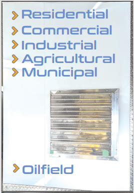

Im confident in my ability to learn and to get this done, regardless of what anyone thinks. I had a discussion with the customer and got a bunch of the text dropped, but he's adamant about keeping what's here in the pics.
I will have help with the install luckily, the rest is up to me however. I took someone's advice here and superimposed the decals on photos of the trailer. unfortunately they were photos the owner sent to me and weren't great quality. But they were better than trying to make a template in AI from scratch. The sizing was definitely off for most parts of the trailer. that was a bad way to start this project.
