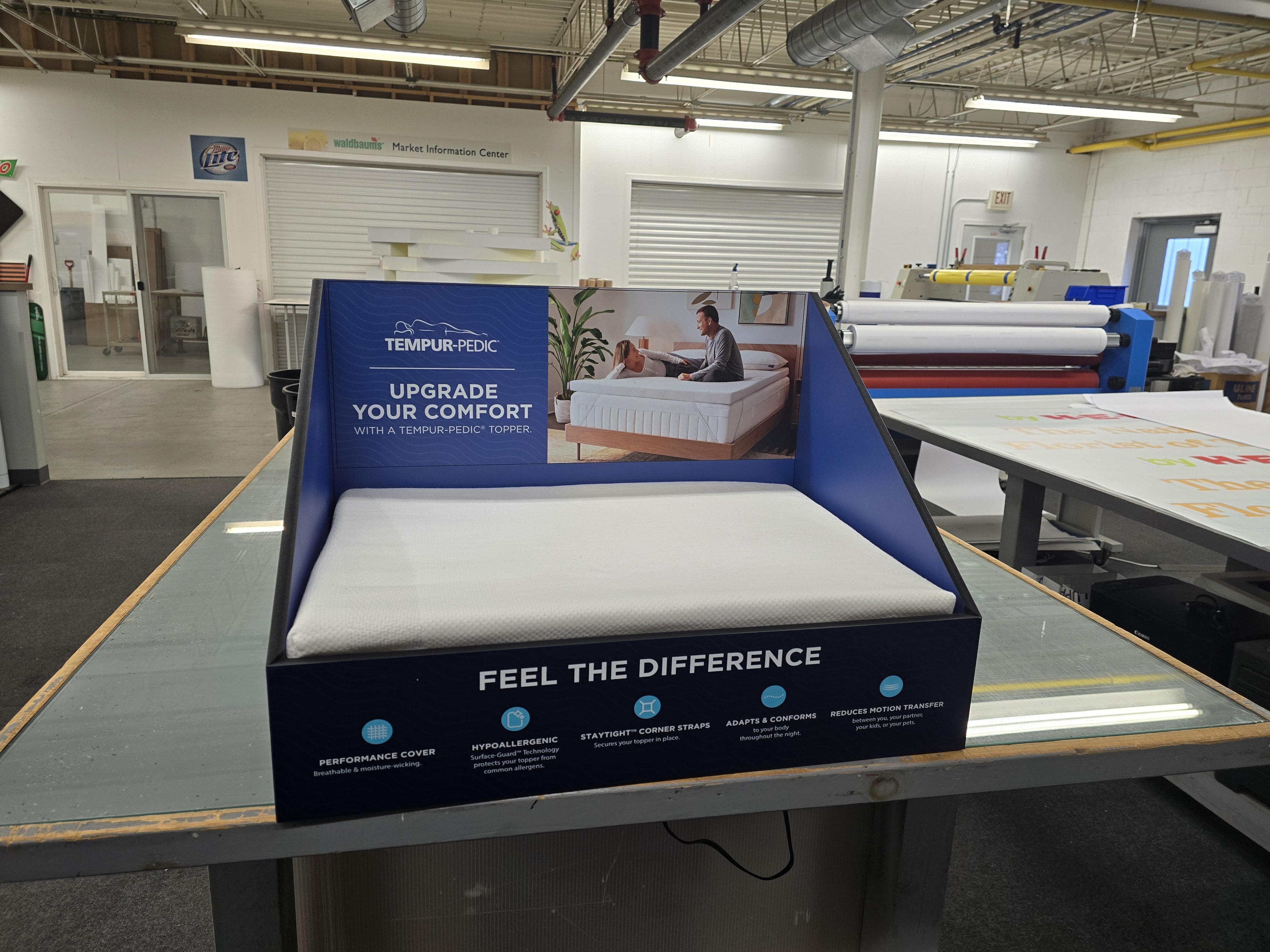

We do a fair amount of printing to the finished size. It does seem to help with the decreased amount of handling it has to go through. The fact that it doesn't have to be masked I'm sure helps a bit too. We actually haven't had any issues lately. We picked up a set of DYNE pens and this whole debacle has really helped me sell the use of print grade material to the project managers. As for the operators maintaining debris free parts......I feel your pain. We are doing a job printing and building Tempurpedic displays. 12mm black PVC laminated and printed both sides with Oracal white vinyl and 3 nested parts. I printed 60 sheets so 180 parts. Each 4'x8' sheet took approx 30-35 minutes to print both sides. I am now being told that there were no bad parts but somehow I am short 6 sheets worth. Hmmmmm......I laid down a layer of roll foam between each sheet. I wonder what happened lol?
