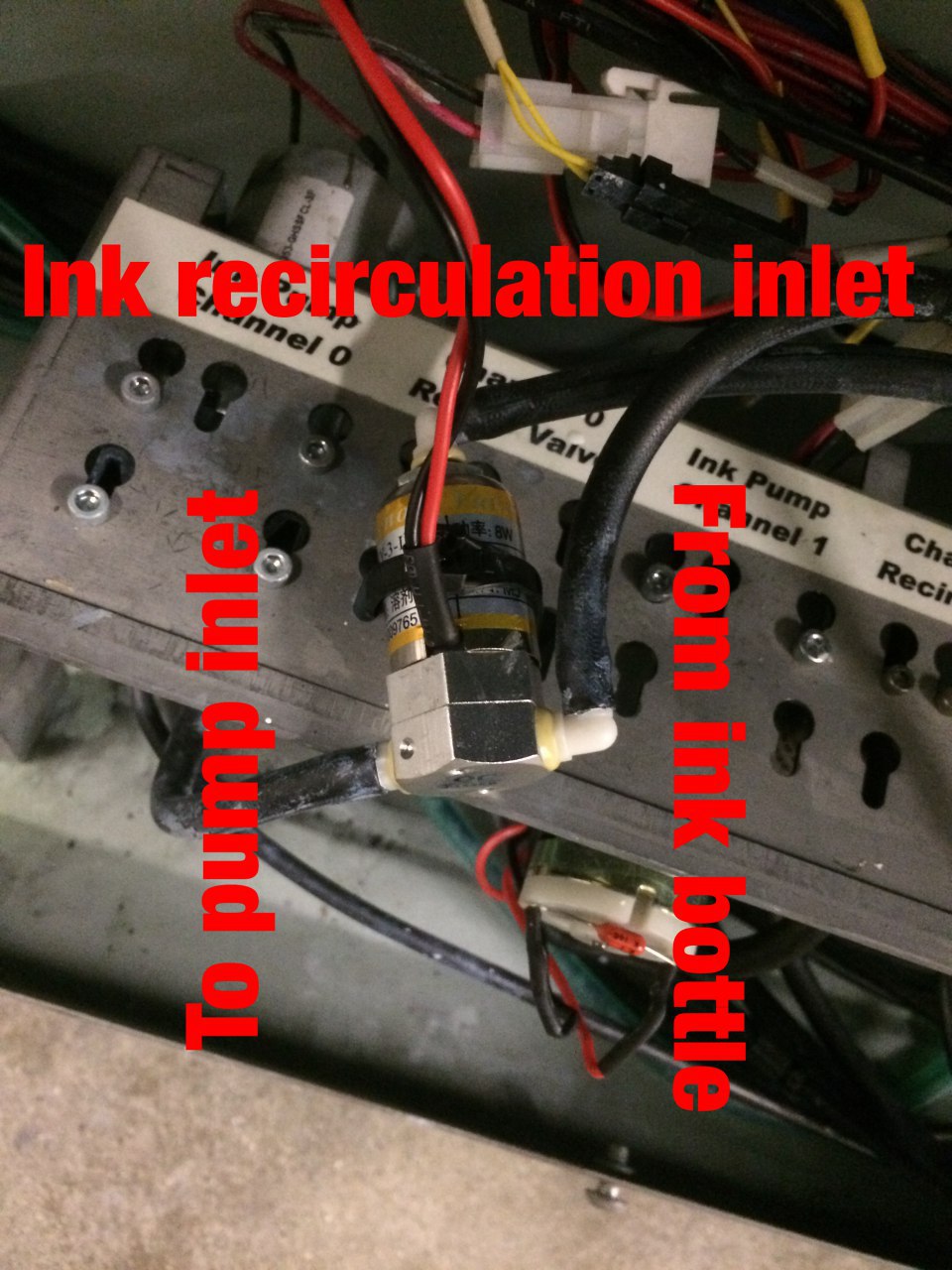

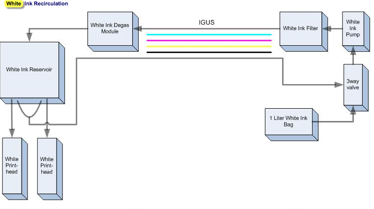

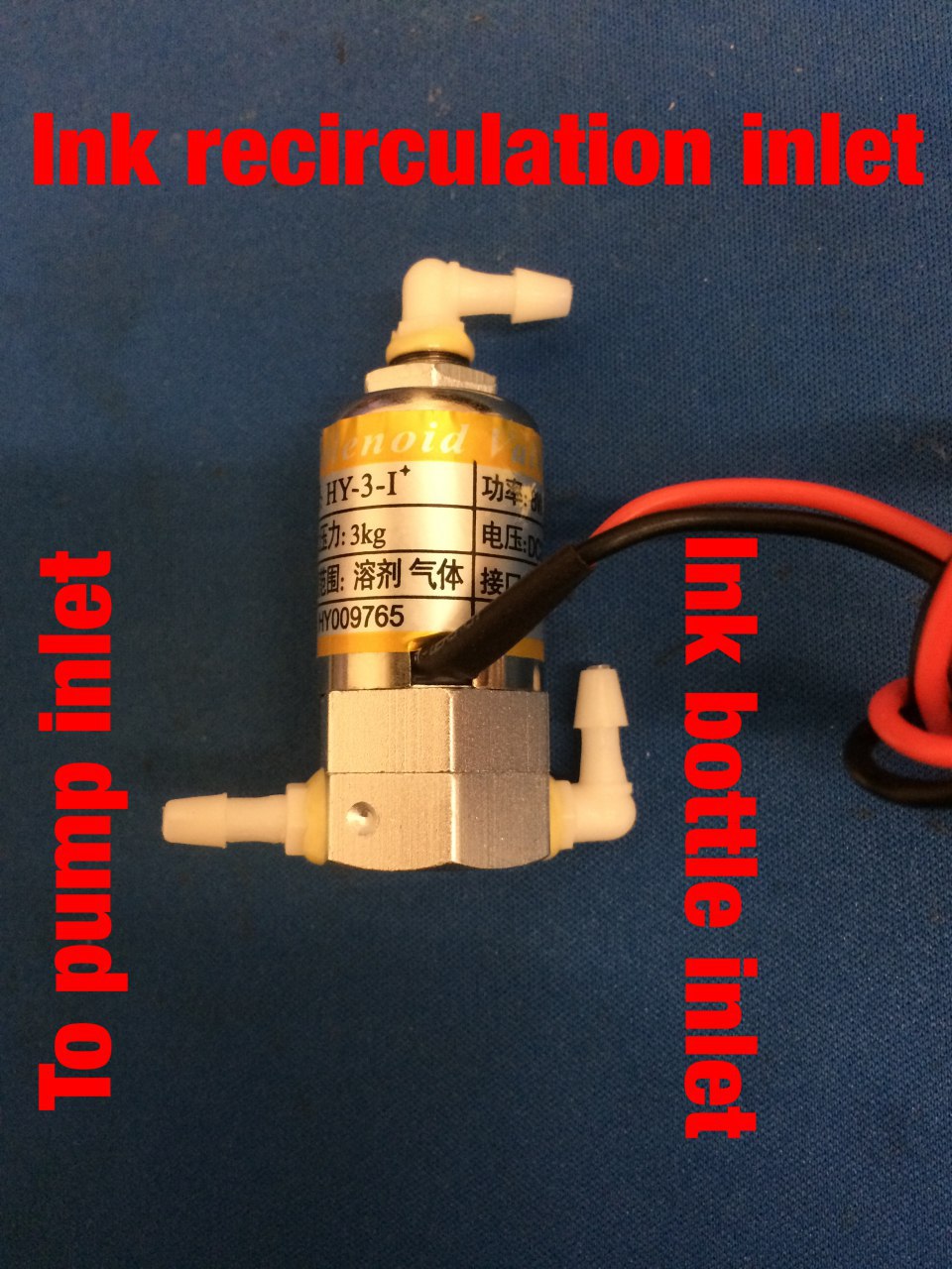

Probably the white recirculation valve has died. Original OEM part number is
3010114396 KIT-WHITE RECIRC VALVE O:3010109356 O:30 but the price is $1,078.79
Several of our customers have no problem with a Chinese made valve.... the design isn't great but its working fine and cost about 50$

Thank you guys for the info. The problem was the recirculation valve for the white ink. I replaced it and now it works great. I did not need to replace the ink pump so I sent it back.
