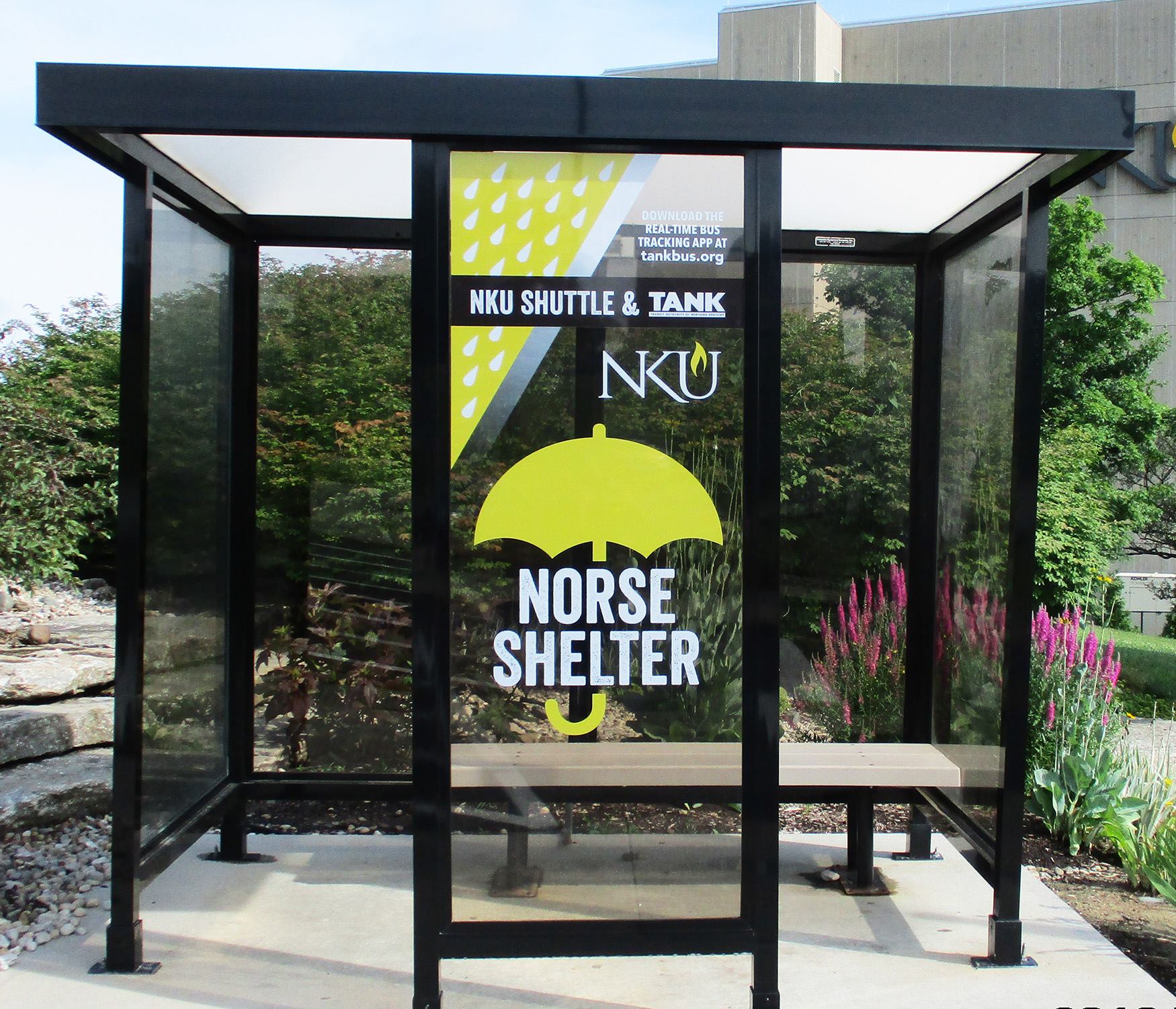

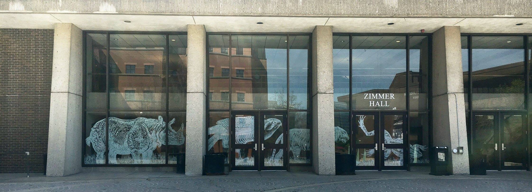

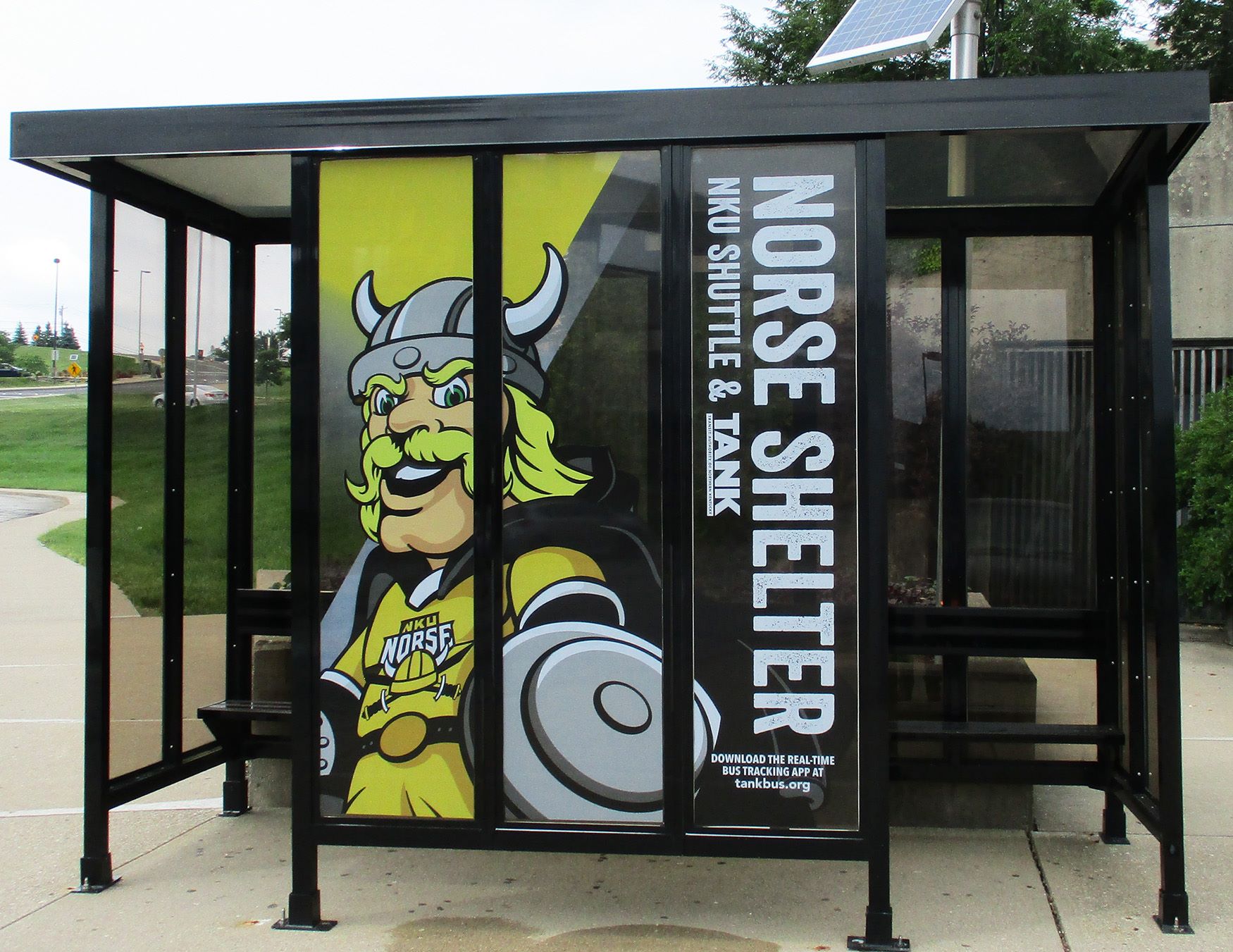

White is as opaque as white ink can be. Which isn't that opaque, more like a translucent white vinyl. Even white print vinyl needs a gray backer/adhesive to be a block-out vinyl. It DOES 100% knock-out reflective though, FWIW.
Attachments: Epson White Ink on 3M 8150 Clear Vinyl with 3M Optically Clear Laminate.
17991393_1487970827902371_800434618083108882_o.jpg 35694770_1926506044048845_5013249186972303360_o.jpg 35789911_1926506060715510_5054975283879215104_o.jpg

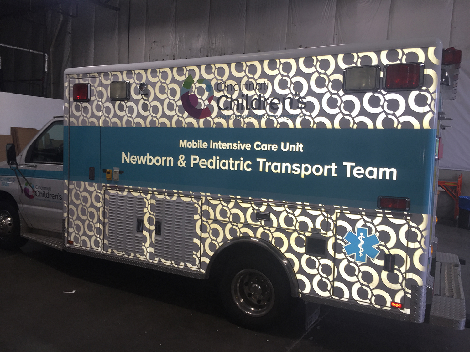

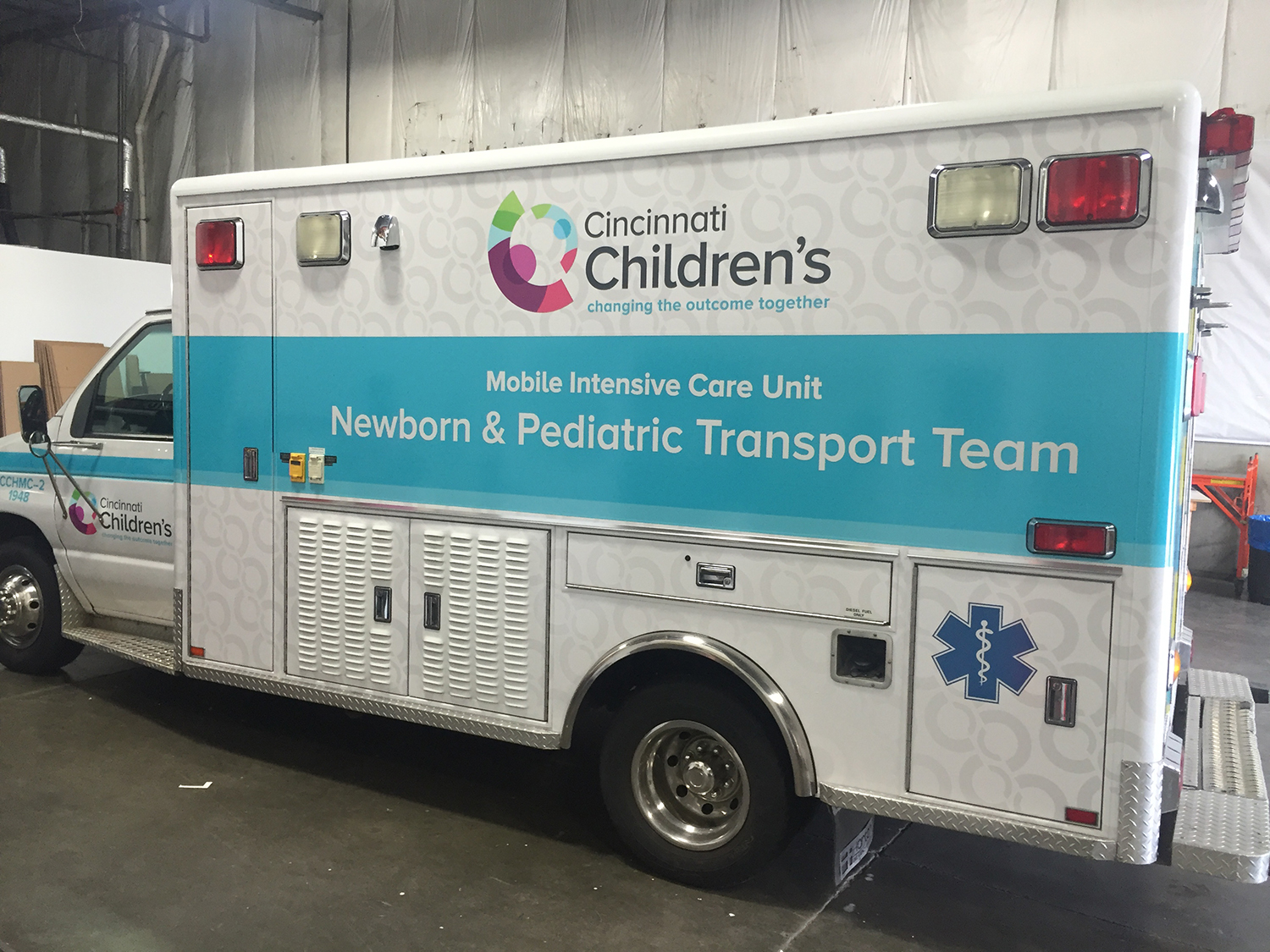

Epson White on IJ680CR-10 Reflective wrap.
