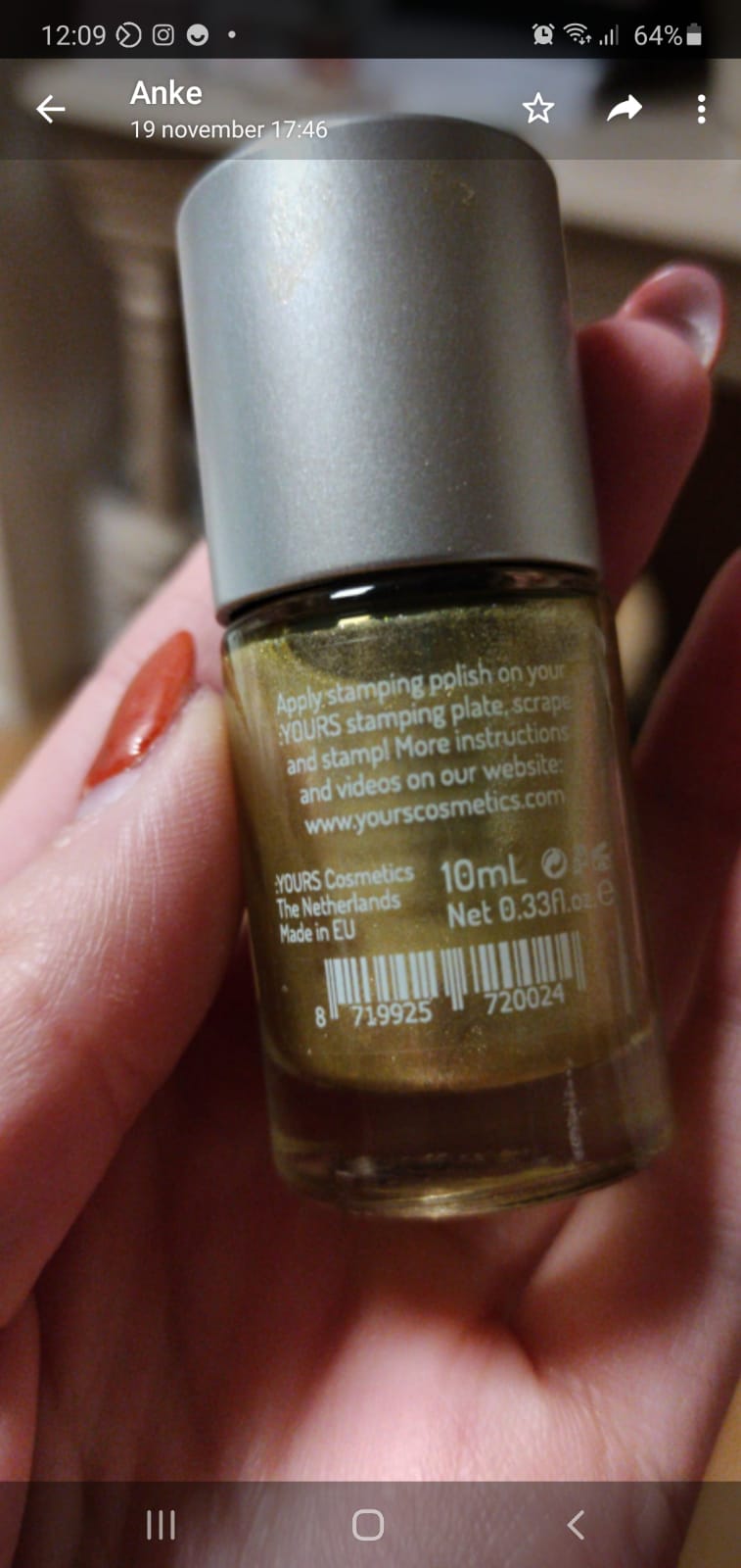

for a client who sells nailpolish product i produce a lot of labels. Most are printed on white labels. Client now wants a product range with glass enclosure. My Roland printer has no white inkt option. So i'm looking into labelprinters that can print solid white on transparant. Anybody has an idea?

We run a Roland XR-640 without white, and we have to outsource this kind of thing to local printers that have the white capabilities. We get so very few people asking for this product that it wouldn't make any sense and buying the machines for it would never pay for themselves... how many labels like this do you get requests for?
Do you have any screen printers with circular type screens over there ?? That would be the most economical method.
