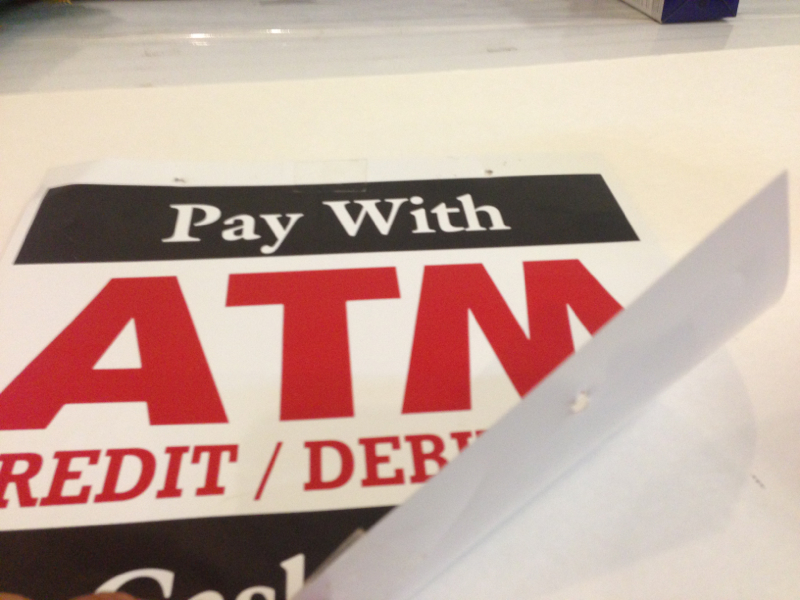

    Good evening everyone, please advise on what material this is and where i camn get it done. To me it looks like a thin, flexible shiny plastic. Is this screen printed or solvent printed?
    Thanks guys

    Com'on, it's right in front of you can't you tell?
    We can't tell what it is from a blurry photo!
    Get a magnifying glass or loupe and look at the edge real close, if it is screen printed, you will see the screen pattern at the edge.
    Most likely screen printed

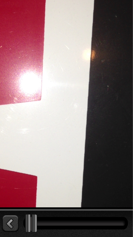

    Im not an expert, sorry

    Looks screen printed to me. Does it need to be exactly the same material? You can either get it screen printed, or they do make solvent printable PVC. It will vary in exact results, but it really just depends on what your final product needs to be for the customer.

    Looks screen printed. White borders are very common in screen printing. Maybe thats a thin styrene .020 or .040. Most sign shops could duplicate that fairly well either by screen printing/flatbed direct printing or printing decals and mounting them.

    Any chance those are thin plastic static clings?

    Looks screen printed to me, but does it really matter? If you can't tell, the customer probably can't either. How many do you need? If you only need one or two, then screen printing is going to be really expensive compared to a digital print or just laying vinyl.
    I have worked with a thin .020 gloss rigid vinyl before (Gill has some in the back of their catalog). It's like a thin credit card material. I bet it's something like that.

    Thanks everyone, i think its styrene, but it really doesnt matter aslong as its rigid enough, its for indoors. I need 50-100 depending on price.
