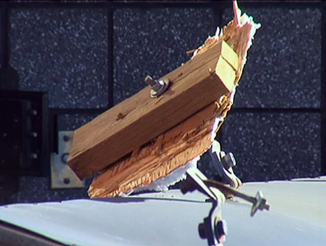

you can see from the pics posted the little 2x4 was saw cut and did not snap off of a larger piece(and about 14" long), you will also notice the 2x4 is still holding tight to the plywood and dryvit. Had the 2x4 bracing been properly put behind the studs you would see the extra length of allthread taken up by the distance of the stud width. But since it is still tight we can see these were put behind the plywood between studs.

sir if you wanted to get technical about this situation it is not the WOOD BLOCKS that failed. It was inside the sign where the heads were. Obviously they pulled through the back of the sign if all the wood blacoks would have been ripped thru the drivit than I would have blamed it on the blocks

good sir, I would not agree, simply because it appears all of the L clips are still on the back of the sign. In the close up of the pic phototec posted you can see one of the mounts doesnt have a piece of 2x4 on it. They probably just used washers like you described seeing earlier.

No you cannot stop high winds but you can make sure you leave a job of this magnitude knowing that anything short of a direct hit from a tornado that sign is not coming off the wall
The only thing I can imagine is the company did not install plates BEHIND the wall studs rather just between them. I would also have been much more cautious with using those L clips and rather flush mounted the sign to the building. i onlt Use L clips on concrete. Never want to use them on something hollow like dryvit as you only have the small 2"x2" footprint of the clip to pull tight as opposed to the entire cabinet

yes because the plate was not BEHIND THE STUDS, and maybe it would have broken a 2x4 piece of wood, which is why us pro's use steel/alum and go BEHIND the studs and also screw the angle/plates into the backside of the stud to prevent it from moving at all

As mentioned, this was NOT a tornado, and the front of the building is still intact. You can see in the close-up photo I posted, that the blocking is cracked from the bolt to the top, 2x4 blocking is NOT enough to support such a heavy sign.
Oh yea, he uses treated 2x4's, he thinks when you treat a 2x4 for rot it makes it stronger, pine is pine and will never be as strong as aluminum or steel. The 2x4 blocking did NOT fail, you can see it with the plywood attached pulled through the face of the building. That's why I say, there should have been long horizontal metal supports behind the wall studs, that way the wind would have to take out the studs before the sign would fall off the building.
