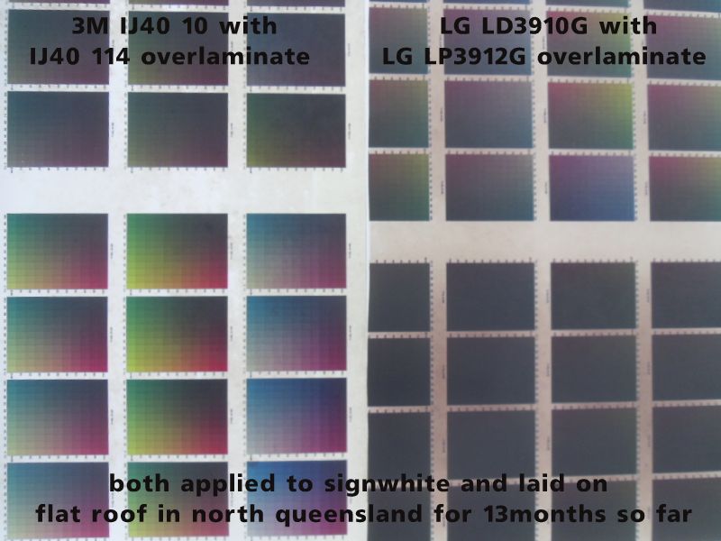

this is the sample we put on our roof top here about 13months ago. not much in the way of shrinkage but you can see the difference between the LG abd 3M for going brown.
also our summer as been rather mild this year with all the rain and cloud cover we have had. this also made it through a CAT5 cyclone

Thanks for that image RadioHead. Do you suspect that one would have the same results with the Roland EcoSol Max inks? (it's what I use).

well just from around my area here i find that the roland eco inks don't seem to lend themself to as much shrinkage or blackening of the overlaminate.
but the down side is that yellow and light colours fade in a year hence why we stick with heavier, or more solvent inks of the mimaki OEM's
