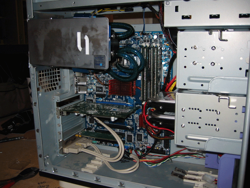

Ok so I got a bug in the rear when I originally built it 2 weeks ago and Over clocked it as well as tuned it.
Heres the specs:
Intel core 2 duo e6850 3ghz (pushing 3.4ghz now) increased cpu v. to 1.375 and increased my mch (n.bridge chip) voltage to 1.33
memory is 4gbs oczp800r22gk rev. 2 sitting at 4;4;4;15 42 with 2.1volts and a 1;1 ratio
added a coolit eliminator mtec liquid cpu cooler (Oh yeah!)
Looking for an another case now, just undecided for the moment. As well as PSUis getting bumped to a 750 - 1000W PSU.
3.4ghz, 378 bus with a 1512 FSB
Did a 15.04.22 on 32m Pi test and a 0.15.043 on 1m pi test, ran orthos for several hours maxing mem and cpu no faults. I can get alot better with additional OC'n but I use this for graphics and work. It lays a wrap out fast.....
This thing doesnt get above 38 degrees under load and idles at 25 degrees (Its in a 100 degree shop for the moment so thats really good temps.)
abit ip35 pro board flashed 11 bios
antec 500w PSU
Intel core2 duo 6850 3ghz cpu
2 160g sata3 HD's raid 0
1 250g HD backup
coolit eliminator sub cooler cpu
geforce 7600
4gbs OCZ ram
Thing HAULS ARSE!!!!!
Took alot of not knowing anything and never having OC to get here in the past 4 days but this thing rocks hands down and is stable (extremely at these temps and Voltages).
