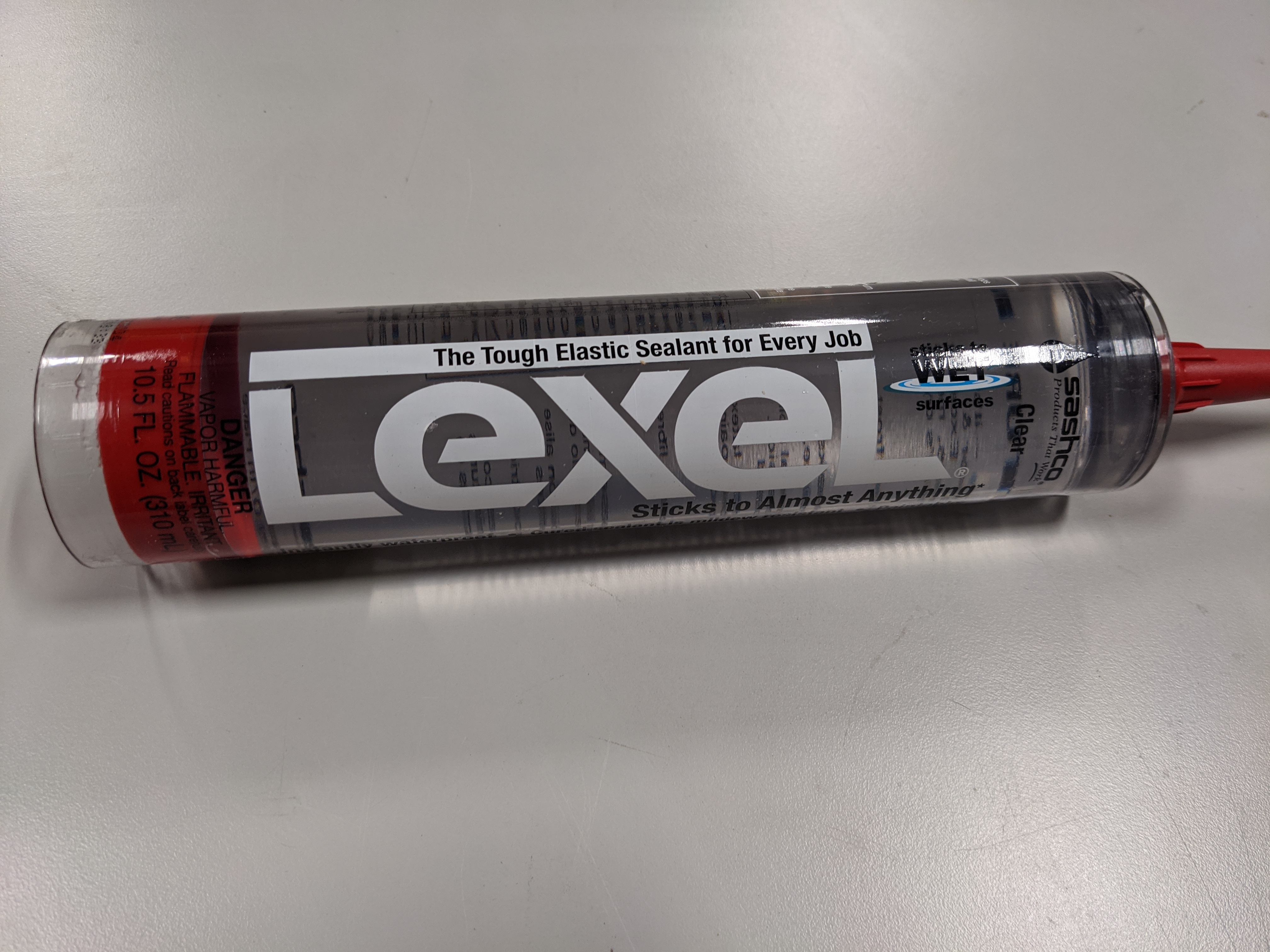

    So I wanted to be a realsignguy and ordered some lexel to see what the hype was about. I've always used 3m 5200 and sikaflex for bonding. This isn't silicone. Did I buy the wrong stuff? If not, why does everyone compare it to regular silicone, which typically won't stick to crap? IMG_20200929_210250.jpg

    Lexel is awesome. I gave up on silicon years ago and started using power grab until Lexel came along. Lexel is thicker with more initial holding power and doesn't dry out and get brittle like construction adhesives. Because it stays flexible, it can handle materials with dissimilar expansion coefficients. The only downside is that it's harder to clean up the squeeze-out then power grab or silicone.

    I wish I would have known that it's not actually silicone. I have always turned my nose up at it because silicone is a terrible adhesive and never understood why everyone thought it was great. Now it makes more sense
