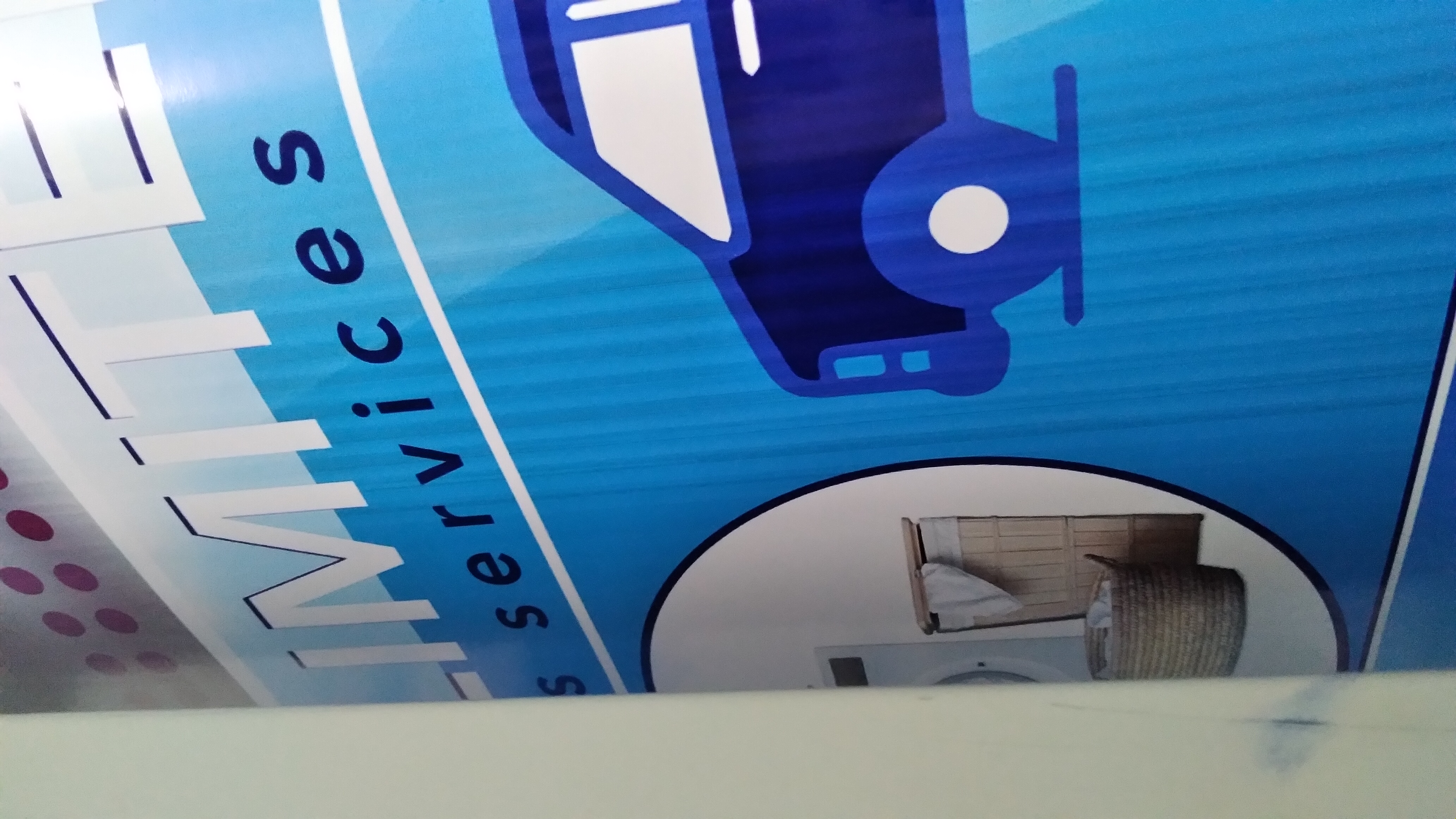

    Hi! I have a CHINESE printer the Yinghe 1.8m printer it has single head. Everytime i add more ink it starts printing realy bad like its failing to mix the colors well. Now this bothers me alot. But in General intime it works fine after so many hours of printing. How do i fix this problem? Please help.

    Think the problem is with the ink&refill, especially cyan.

    Can you add ink SOONER? (before it is that low? Do a cleaning cycle after adding? Is there something odd in the way the . cartridges/ink tanks are vented & a procedure you are not following? I as the new ink completely compatible?

    Could be any one of multiple issues. The ink shouldn't need to be "mixed" - it should all be the exact same from batch to batch. What I'm seeing is dropped jets or cross contamination when a color gets low. Does this thing have ink dampers in the head? Are they secure/air leak free? Is the capping station maintained? And sometimes.... you just get what you pay for.

    are you manually filling by pouring from a bottle or are you simply replacing ink cartridges?
    my best guess is that you ran your ink low to the point of starvation and even though you've refilled the supply you're still not getting fresh ink to the printhead properly at the start of your print.
