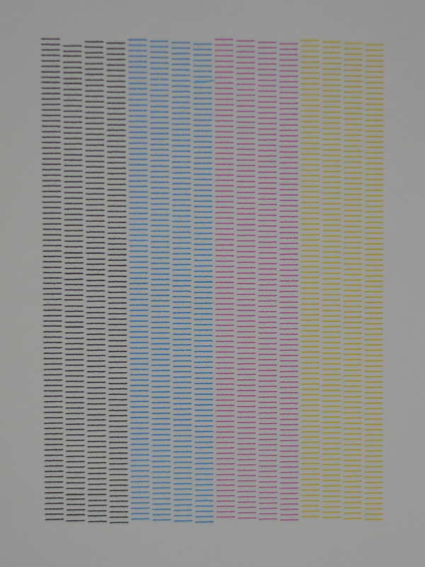

Ok, I'd really like replies to this:
In an attempt to get a nice, neutral B&W print, I've now tried every possible setting combination for using the K channel only, but no matter what, I keep getting that fine banding which suggests a problem with the K nozzle. If I let it mix CMYK to produce the B&W, it prints really nice (smooth, without the fine banding) but the gray is off (too pink/green etc). It's too bad, because the grays are not bad using K only.
So should I use one of those cleaning cartridges that came with the printer and run it in the K cartridge slot? Will this clear that nozzle?

Don't see anything amiss there. Not too sure how it works on a Roland but is there some kind of media compensation setting?
For instance, on a Mimaki there is a media compensation setting that allows for a brand new (heavy) roll of media as opposed to a near finished roll that would require less pull to pass it over the grit roller.
Maybe there's something similar on a Roland. Just tossing out ideas.
Then why the heck would I be getting that fine banding with the K-only prints?
I've tried slack & no slack. No difference.
If the nozzle is clogged from below, it is doubtful that a cleaning cartridge will work any better than the K cartridge to dissolve the clog from the top.
If it mearly deflected, then it could be dried ink on the nozzle plate or damage to the nozzle itself.
For clogged nozzles head soaking is recommended.
And yes, you can print K only.
But output will depend on droplet sizes, variable droplet curves, dithering patterns, etc. Which would all be optimized through a profile.
And if you are using a CMYK profile that was optimized for all carts, then it may not produce the output that you want.
You might try testing at the highest resolution.
This typically will use the smallest droplet sizes.
On our printers there is a real time micro adjust for the feed.
If you have something like that, you can adjust on the fly and see if it is a feed issue, or just your missing nozzle.
