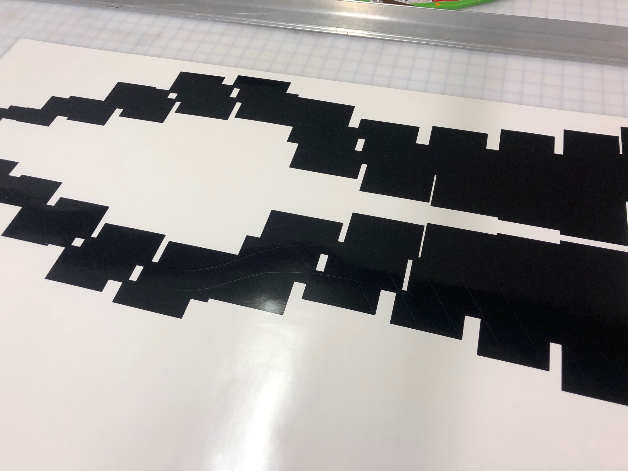

Here is the example I dealt with tonight. This is a large set of waving checkered flags. It decided to cut around every little checker around the edge. Even cut out some inside spots (shown already weeded as small rectangles) within parts that will also have to be removed anyway. Not sure why it does these random patterns like this but makes weeding WAY more complicated than it should be once it does this (not to mention the extra time it takes to do all the extra cuts around everything). Will do it around lettering occasionally once it gets in this mode too.
