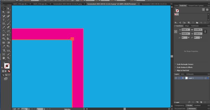

I opened it in Illustrator CS3 and your lines are not actually lines. It looks like you expanded them. If you zoom in close you can see that your lines are actually super long skinny geometric shapes rather than a single line.
Desert_Signs

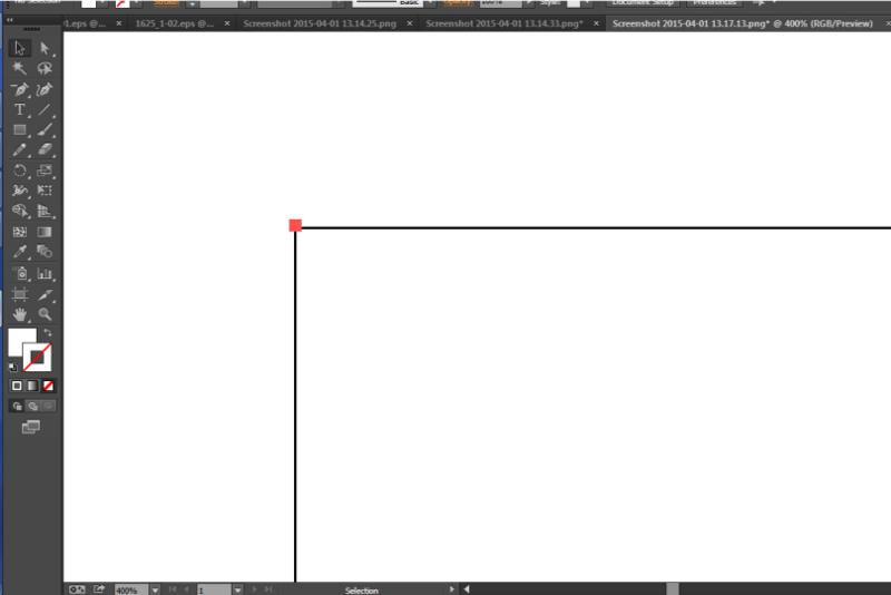

Hmm, I'm not seeing that either in preview or outline mode. They are just lines, even when zoomed in at 6400%.
Desert_Signs
Preview and outline mode.
