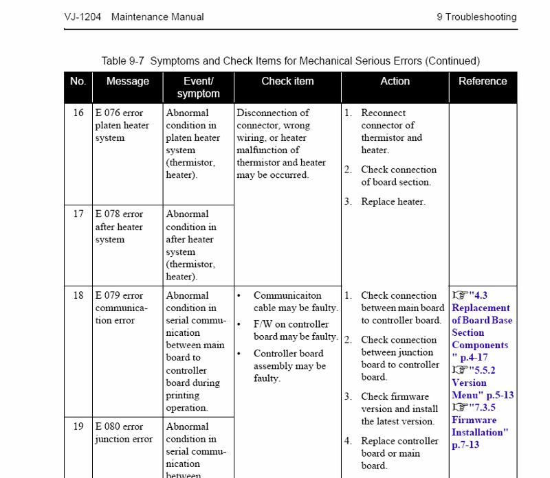

That error code you put up lists as an error between the main board & the controller board.
If you don't have the service guide pm me an email and I can send it to you.
You might be able to clear this 079 code by opening up the machine and re-seating all the cables.
