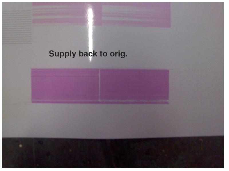

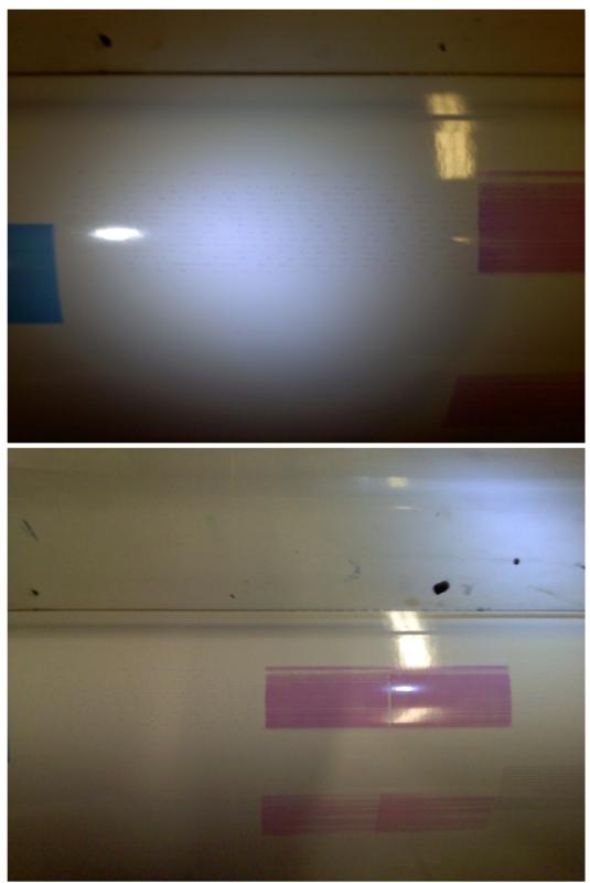

OK so I have been having this problem for a while now...Magenta nozzle check will be fine right when I turn on the machine...run a clean, and it goes to crap (like 20% firing correctly)...

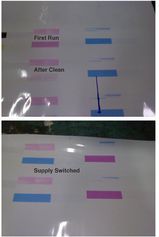

I swapped supply lines C with M to see if it was a supply issue...nozzles performed beautifully on both swapped heads..before and after a few cleanings...
Swap them back, do a clean, and M goes to crap again...
I cant see it being supply, because magenta came in fine on the C head...
I cant see it being capping, because cyan came in fine on the M head...
I can't see it being the head because again cyan came in fine when switched...
Any thoughts?

It got ALOT better after a thorough manual head cleaning - seems a bunch of gunk was building up where the cap top lip sits on the head when parked...I will continue to monitor it
