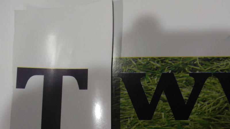

I use Versaworks and have a Roland VP 540I. I changed the K and M head went through all the steps and test print look good but when I print. Colors are,not the same as they was. Before I changed the head and now I am getting this. Yellow along the edges of all prints and I noticed this white,above the black letters in the grass. Does anybody have an idea on what I need to do. Thank in advance 1005162051.jpg

that is probably either overspray or an alignment issue.
did you do all the necessary alignments after you changed heads?

Yes and I thought I was pretty thorough, but I was thinking about redoing it again. I've got some color sthat I have printed in the past that are not printing the same now they are different
