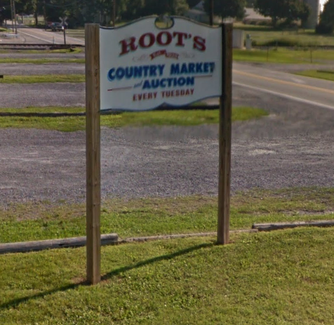

I am attaching a photo. They are wooden posts. He would prefer not to attach to the sign main sign and just have it attached to the side posts. I make signs for many of the vendors at different markets we set up at but it is not the main part of our business. Thus, any suggestions and advice would be appreciated.

Oh well now that I see this just add an MDO piece and call it a day.
