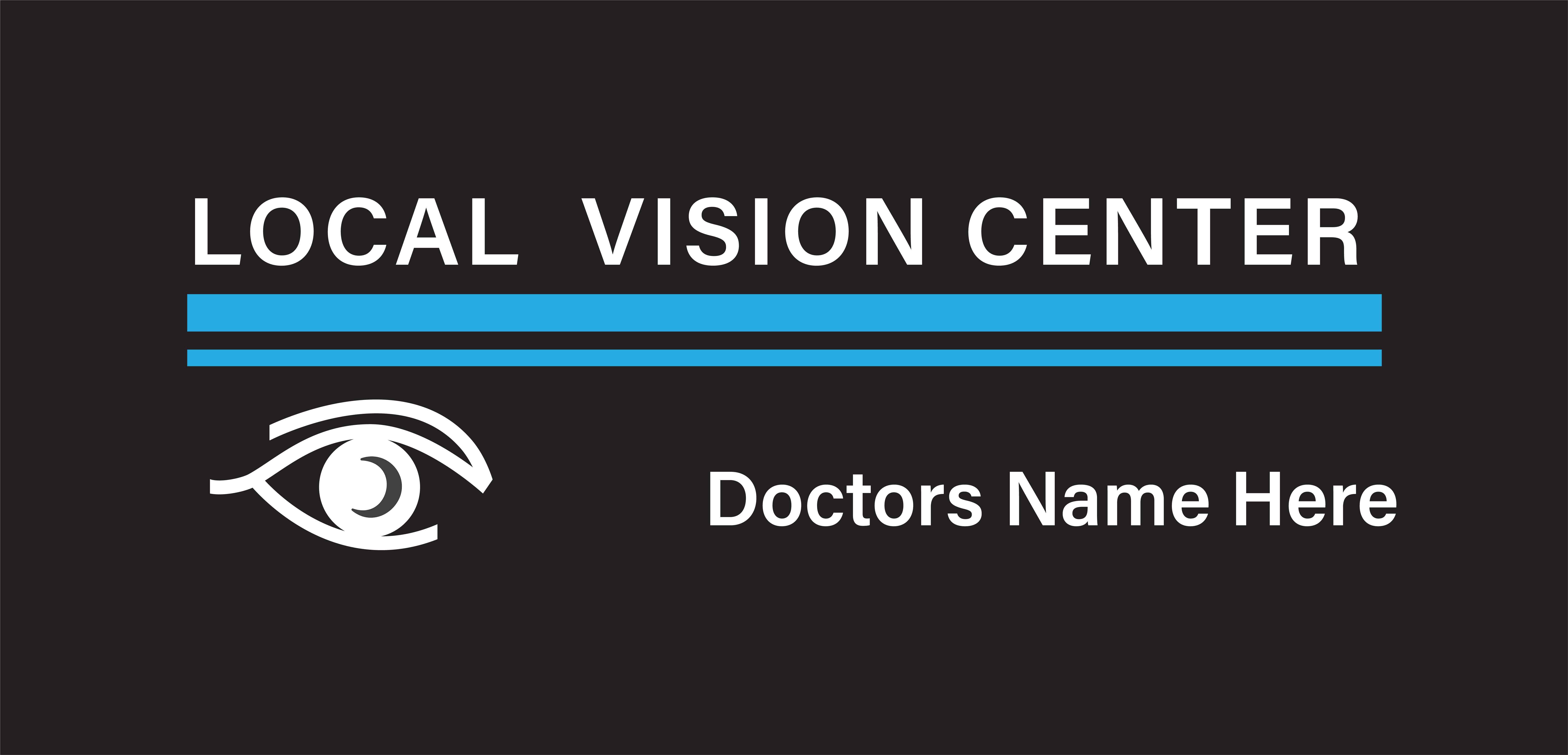

Part one: We recently installed perforated and laminated vinyl on a local window. The window was a double pane. The image area was printed in rich black with approx 90% coverage. The balance was white or a light blue. The windows are southern exposure. All factors I've learned since - from this forum - factors that could have lead to uneven thermal expansion and the window to crack. Just that thing happened the day after installation.
Part two: It took a bit of searching here to find out that it can happen - it's a very low percentage and frankly I had no clue that COULD happen.
Part three: I turned it over to the insurance company. They want to contact the mfg - we had it printed at signs 365 because of the size of the window and ink coverage. I suspect that they have never heard of such a thing happening either. So connecting them there solely seems it could be counterproductive. So I guess what I'm asking is can anyone point me towards an article that states this can happen? A google search has yielded little. Or has anyone experienced something similar and how did you manage it?
Thanks.
SV Signworks
Here's another part of this - They are switching to tempered glass and want to have the same application. I don't find myself in a similar situation. Any info on tempered glass and printed/laminated perf. Oh, and if you wonder why we'd laminate - the customer wants the glossy look and is concerned also about local kids scratching the ink off.

I have heard of solid black vinyl causing windows to crack in extremely hot climates, but it is usually because either a crack or stress already existed in the glass and the heat from the vinyl sped up the issue. I can't see it happening with perf as the window is only 50-70% covered and you are in Idaho, not southern florida.

I'm only guessing here, but with that much black and having it laminated, I think the wrong approach was used. Knowing that regular annealed glass was in there, should've been your first clue not to put 90% black vinyl on it..... perf or otherwise. When the chips stop falling, you'll most likely be the blame for using the wrong materials and insurance won't pay for it.

Thanks, Gino. I agree with you. This was the first time we'd ever had an issue. BUT it's also the first time with the heavy black, laminate, and then annealed glass. It was an unfortunate rookie mistake. I'm just looking to not make it again.
