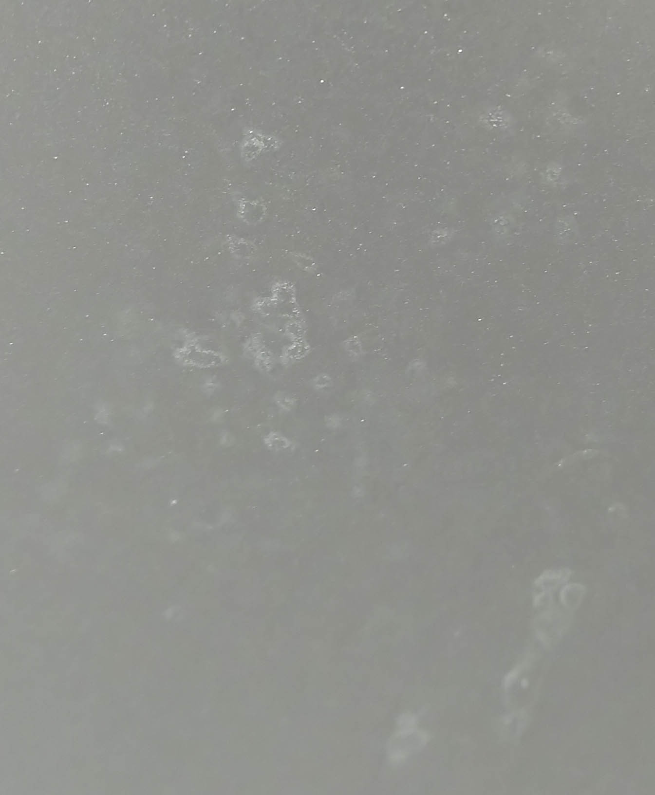

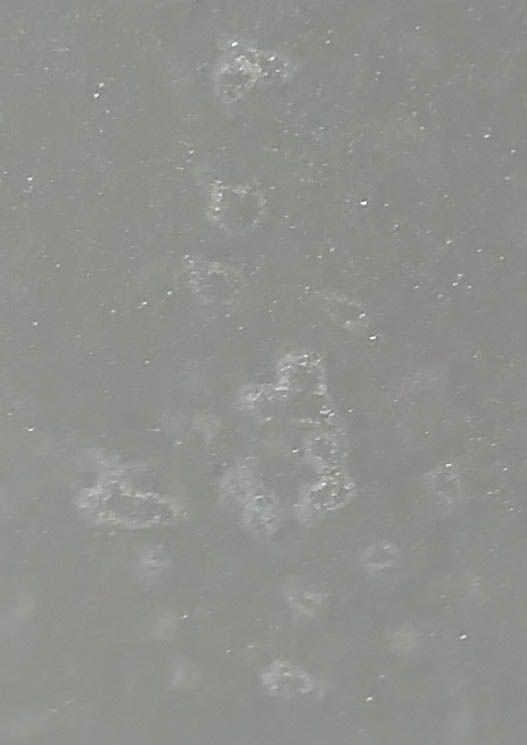

OK I've DONE IT. thanks all for the advice. On the whole happy with how it went. Now I've just got to get all the water bubbles out. tiny pin hole? not ideal I know but I can't think of many other options. Obviously where I can I have I push out to the edge (with a felt tipped squeegee) but there is a lot where its just two far from the edge of the film to do this. Any thoughts. Maybe the smaller ones will come in out in time?. thanks Simon

Bubbles?
Strip the frosting off throw it away, and do it afresh - with more experience and no bubbles this time. None. You can't leave them there to be popped.

The bubbles should be removed when first applying. The longer you wait, the less chance you'll be able to cleanly remove them.

bugger! I might have to do again. It was 3 days ago I did. For some reason I was thinking it was like air realise vinyl.
All liquid needs to be removed! did you use a home made formula?
Yes, but mixed carefully ( percentages as recommened by "Oracal") baby shampoo and Isopropyl alcohol. Sort of resigned now to having to redo. I guess this is how you learn.

Wasn't squeegeed hard enough. Gotta squeegee all of that out from the get go, it won't come out now. It should definitely be redone.
