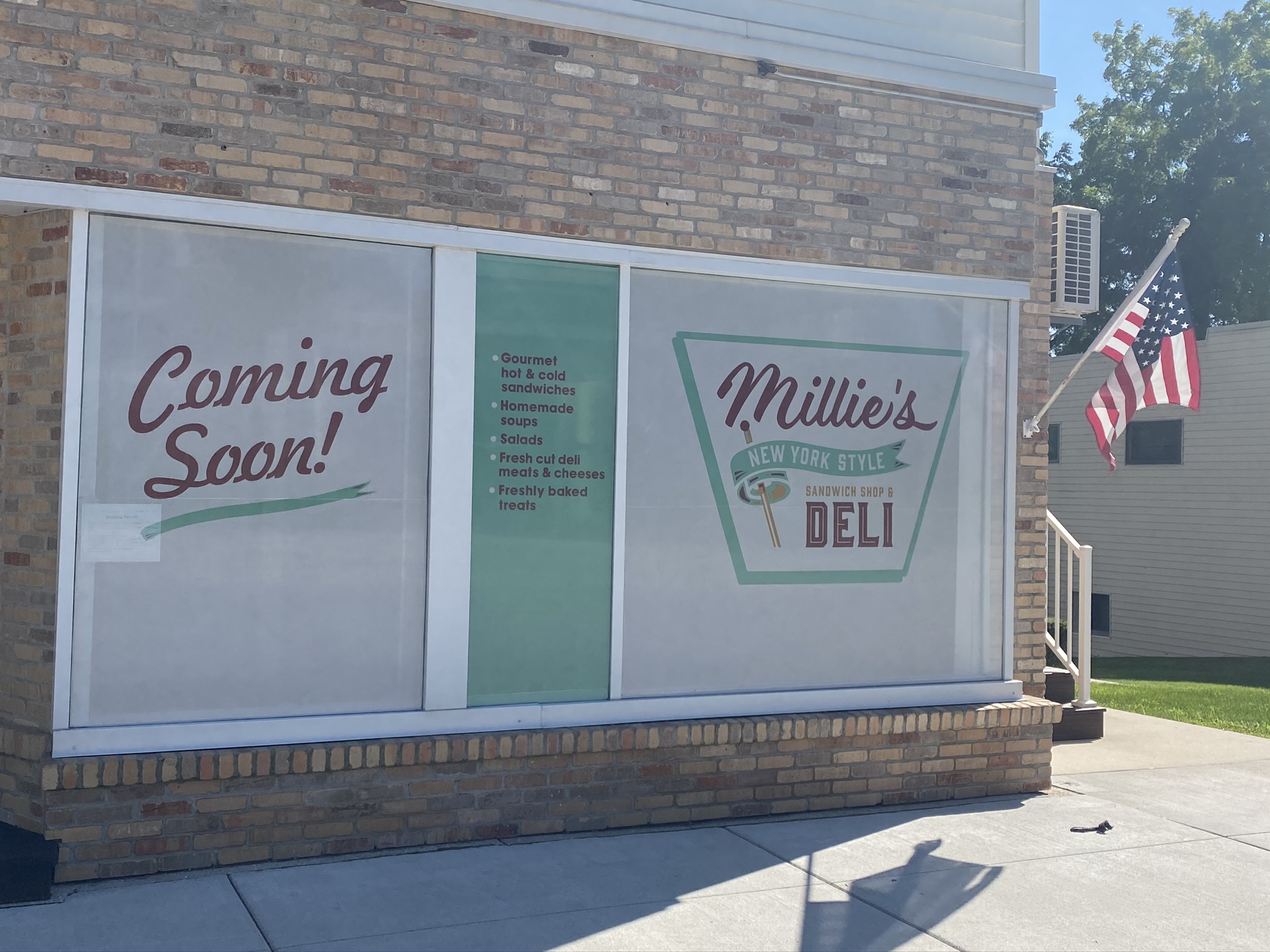

Just got this installed. Took myself and my 2 teenage boys 2 hours. Turned out ok but I don’t feel like I did this the easiest way! Middle piece was one. The sides were 2 horizontal pieces. What is the most efficient way to apply this? We sat there staring at each window for a while lol good bonding experience I guess. Put the tip left piece up first with the hinge method down the middle. Same with the bottom. The right side we started on the right and worked left. Then the bottom we pulled 8” off the top and lined it up then worked down. We got it but...not sure if it was the best method lol

Oops...the photo didn't upload Friday. I can see the seam a little bit on the left. I can stop back and trim it.
