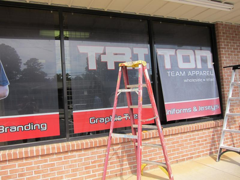

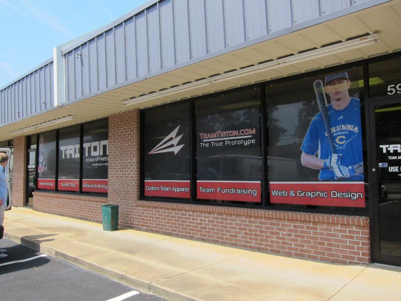

it took me another guy about 3 hours to lay all these down, not too bad. we folded back the top backing about6" and got that straight and he squeegeed with a 24" felt tip as i unrolled from the bottom. We did have to go back and trim to bottom corners as the material did strtch just a little, this was NOT laminated
