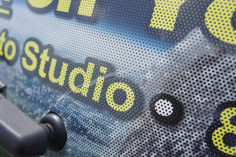

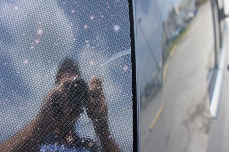

    Recently installed some contravision perf with a curvalam onto a Mercedes Suvs back window. Instantly the laminate is leaving major release lines from the perf itself. Is this happening to anyone else? Open to all suggestions. Owner wants the perf to be laminated as he uses his back window so no lam will not fly b/c of the rain.
    Thanks in advance. Check out the pics
    Im lost on this one!!

    Maybe an outgas issue, something on the perf, or a bad roll of lam? I'm not much help as I spray mine. No one ever asks for lam.

    My guess would be you didn't let it dry long enough to out gas totaly.

    We are using a l25500 which u are supposed to be able to laminate as soon as it comes off printer. (latex printer). However the print did sit in shop for 48 hours before I laminated it so should have been plenty of time I would think.

    Install issue.

    Could be install issue, I have done about 30 perf installs before and never had this issue until I used lam. Wrapped a few cars in my time without issues and perf has always been the easiest part. Colorado what do u recommend? Used my regular technique medium pressure with center hinge. No heat until I saw problem afterwards which cured it for moment then reappeared 5 minutes later. Dry install clean window. I dunno what's up with it ???

    had a similar problem a few years ago. Guy I subbed out to had too much tension on his laminator or so he said. His next attempt sat fine

    Try boosting your cure temp a tad. Letting it sit will not help as the ink is heat cured, not air cured on the 25500. Another thing to try is to hit it with the heat gun after printing to finish the curing before you laminate if you are noticing just small areas releasing after lamination.

    Cut back your edges a little and apply some lam in half inch strips around the edge to help those outer edge lifts.
