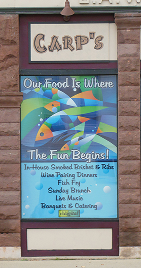

    Pano Film from fellers works really well. Film is 80/20, so it's a nice saturated print.
    Here's a window we did for a restaurant down town. There's a lot of glare in the photo, it looks better in person.

    Is that mounted from inside or outside ?? It's about the same cost as the Magic Perf.

    ^^^ This. I use this product with a 1/3" permanent/re-useable tape for application.

    Mounted on the inside with 1" Pano Tape. Tape is permanent on the graphic side, removable on the window side.
