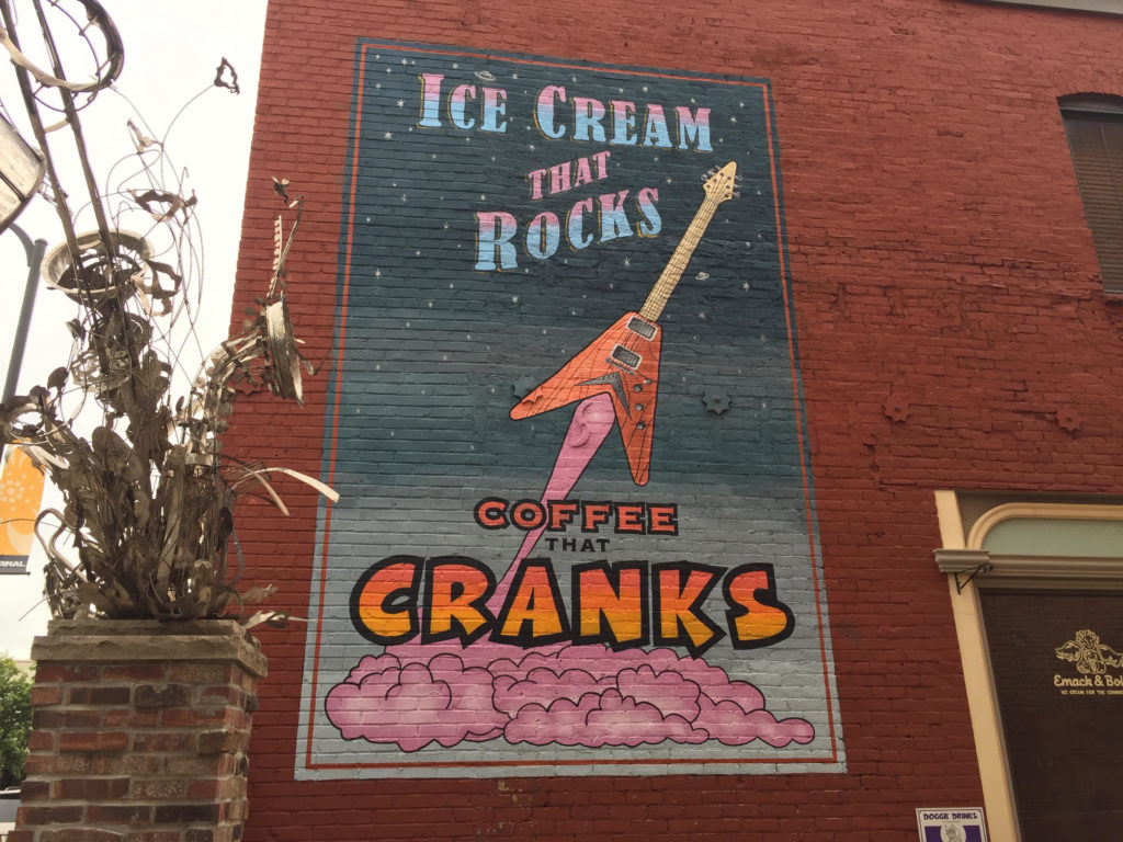

    I don't do many real wood signs anymore, but when I do they are primed with a stain blocking alkyd primer and top-coated with high quality lexterior latex. I do not use acrylic polyurethane on wood signs.
    I have yet to try the Nova acrylics, but from all reports they seem to be a good bang for the buck. I have been using Golden acrylics for years with fantastic results, but they are a bit pricy. Attached is a sign painted 12 years before the picture was taken. It still looks great 14 years going!
