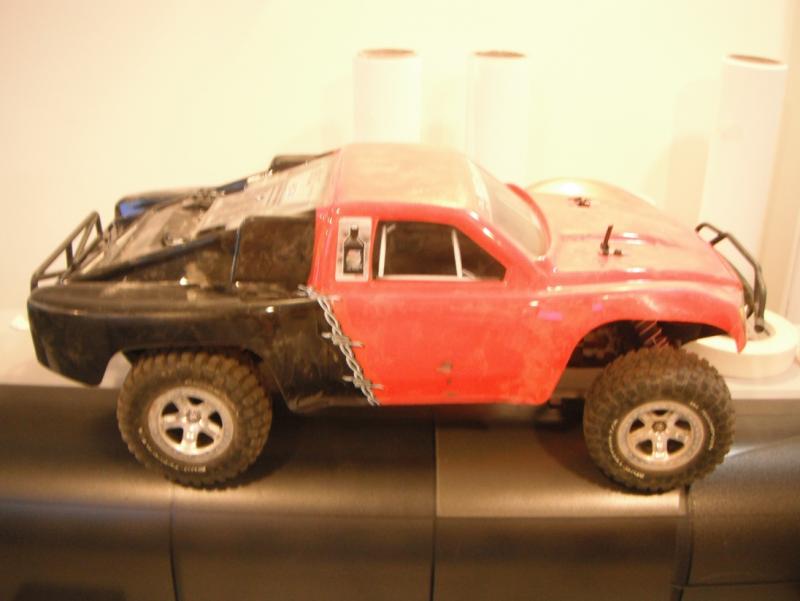

The guy dropped it off and I'm looking at it and the plastic is really, really thin and I'm afraid if I took a torch to it, I'm going to melt the plastic and besides that its so flimsy I'm not sure I would be able to put any pressure on it to get it to wrap.
Just wondering if anyone has ever wrapped a Racing RC Car before.
Its suppose to be the "PACE" car for their track.

I would get a new body for it ($25) paint the inside then put some decals on it and be done with it.

We wrap a lot of them. $65-$95 a pop. Customer installs.
FYI: $200 wouldn't touch a full race version.

I've messed with my own a bit - cut some tribals or designs - stick it on the inside (should be a clear body) then paint inside with a solid colour. Actually wrapping... mmmm.... I'm not so sure how that would go or stay..
The bodies are polycarbonate I think, so they're a lot tougher than they look.

Typical wrap film. I wouldnt use a torch though. I suggest heat gun. And no matter how good you install it, the wrap never holds the body shape. I tried using 180cv3 with no real luck.

Latemodels & most other dirt oval I use 651 as they are mainly flat panels. all Off-road I use MX. It holds up much better. and yes, heat gun is a must.
