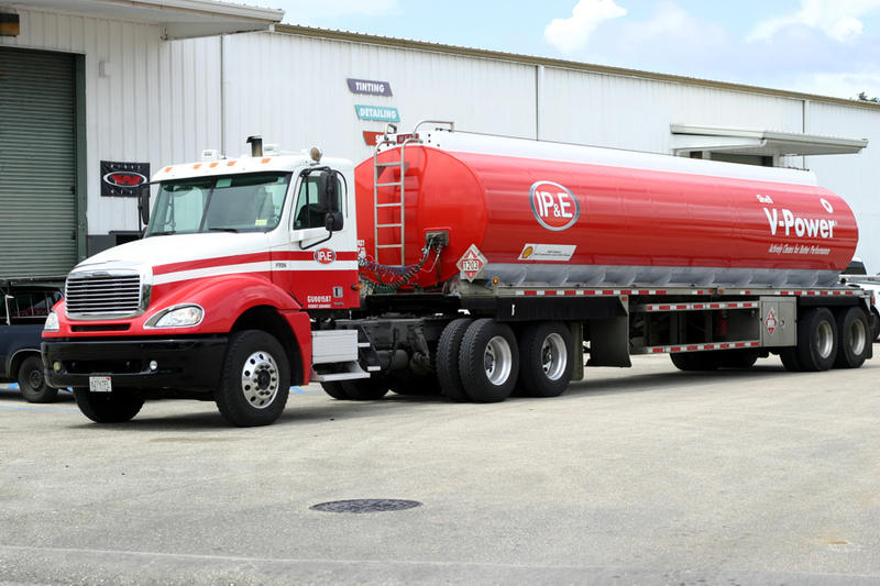

We had to do a good sized fleet of fuel tankers up to about 42ft long.
We took some excess pallet racks we had and welded the cross pieces into the uprights at the height that made it comfortable to work from the top of the tank down to the lower weld lines where our stuff stopped.
Built a back rail to keep from stepping off the platform & laid plywood with 2x4 supports down to stand on. 12ft long so we only had to move them 3 or 4 times to cover one whole side.
One for each side so we didn't need to drag them around and could work the side that was not exposed to the sun and rain.

We did wrap those the catwalks - the trailers came in unpainted semi polished aluminum. The height of our work decks were about even with the trays along the bottom of the tanks. We could reach up to the base of the catwalks to lay down the red and then worked from both the top and side to cover the sides of the walk.
Without that up there you'd need a little more height and maybe seam it right down the middle of the top where it will not show. I think a wooden step box to put on top of the deck would do. One of the shorter guys working with me needed one to reach the top of the red. Guess it will depend on the shape & diameter of the tank.
