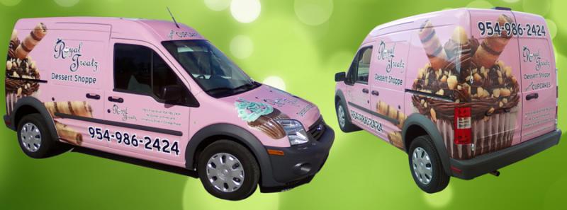

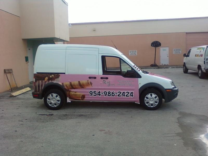

almost all vehicles will have a horizontal trim line where the seam is hidden. I find it faster to install horizontal because I dont have to align any text later on. try aligning text on a vehicle like an HHR with vert panels. As soon as you hit the fenders you'll be in trouble. the horizontal seam is usually going to go either in the bend on a van or across the window pillars. you can usually get away with just a .25 overlap.
