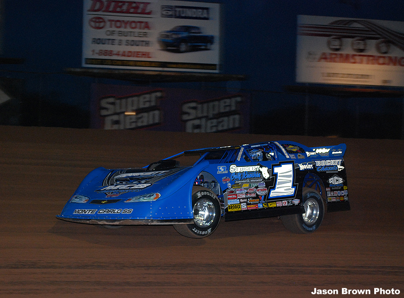

I also have a 30" printer if I load 33" film into it I can print 31.5" panels. In this instance I would run one large piece down the side. If you cannot do this then I would panel it but do it towards the bottom so the seam isn't to noticeable.
Not sure who told you to stretch it 2" but I wouldn't advise that.
