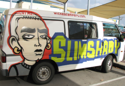

I'm not really a wrapper
So your company fleet doesn't look like this? Oh yeah, I think you said you have a minivan. :cool:
