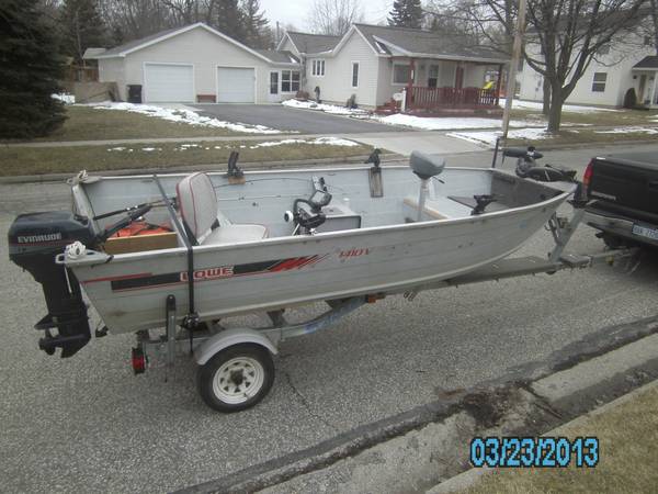

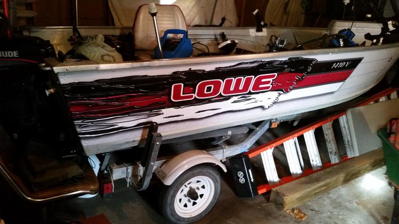

Ok, Ok, take it easy. I now feel like I need to pre-qualify the use of the word 'awesome', but this boat is a '96 and spent every spring, summer, fall docked....dock rash is an understatement. I spent 15 to 20 hours doing surface prep to get it smooth and clean. Anyhow, I dug it out of it's winter slumbering hole well enough to snap a shot.

Man what a difference!! Turned out great.
That boat is sweet to begin with. I've got a little 14' with a 14hp stashed at my buddy's cabin. It looks like a piece of crap but works like a charm to troll for walleye.
