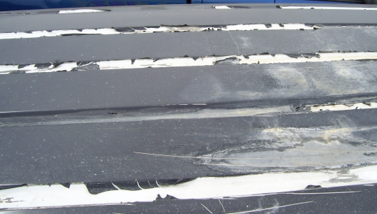

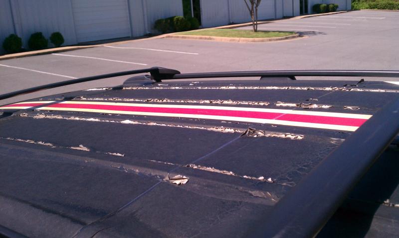

Does anyone have any suggestions on removal? See attached Picture.
The pieces are coming off about the size of a dime. If we use heat or no heat the size is all about the same just different amounts of adhesive left behind.
Help!!!
There has to be a better way!

Rent a steam pressure washer or hire someone who has one. A Wagner will still be slow going but with a steam pressure washer you can blow the old vinyl right off without damaging the vehicle surface.
ngates
Yeah, I was just talking to one of my partners about needing a Snickers.
I have a regular pressure washer. Do you think that would work?
Craig Sjoquist
Wagner steam cleaner works fine but still be slow but a lot faster then other methods if poor paint job it will peel up paint also.
Pressure steam oh yeahh like to try that.

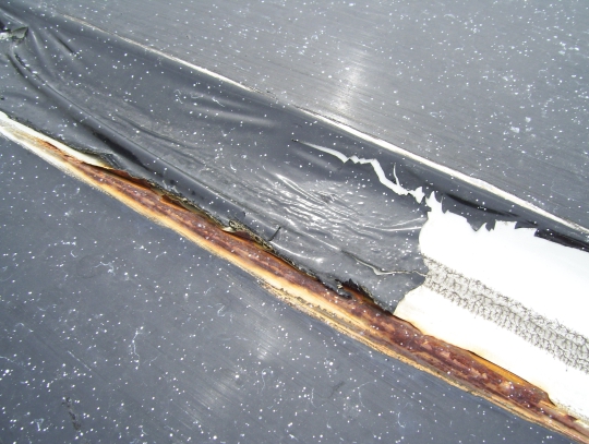

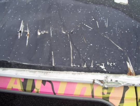

Look at this Beauty! One of my first jobs...black vinyl on van roof, scraped and banged up from drivers going through drive through's they shouldn't have.
NIGHTMARE. Leaning over the top, fingers rubbed raw ...we turn those down.
