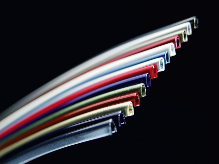

Our solution...3M Edge Guard Strip Protectors!
